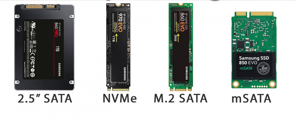

Check out comment from Kevin in this video I think it can support 500gbs

The specification says 2.5" HDD and M.2 2280 SSD. The specification does not mention if this is a NVME slot or a M.2 SATA slot. The video posted by @getmarkked also shows a M.2 2280 SSD. So in all probability this is only a M.2 SATA slot. You can install any of the two mentioned below.
Buy this if you want to remove existing hard disk and use an SSD instead - https://www.amazon.in/dp/B073SBZ8YH/
Buy this if you want to install a SSD without removing the existing hard disk - https://www.amazon.in/500GB-Internal-Solid-State-WDS500G2B0B/dp/B073SBX6TY
@vaibhavyagnik @Titokhan So i tried WD SN550 1tb and i couldnt even pop it in , Saw some videos also the one mentioned here , I need SSD with 2 holes (B&M Key or something) But i am still not sure if i can only install 256 or 500 gb Also can you guys suggest any ssd with those 2 holes ?
So NVME Didnt fit in And i ended up installing Kingston 480GB A400 M.2 , Thanks everyone for helping <3 , Mods please close this thread
