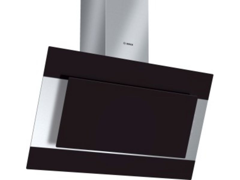

The slanted model looks cool. Are these the fans you are talking about http://www.cataindia.com/ExtractorFans.php Do you think these will look better than the chimney setup.

i have double the size of chimney exhaust covers which almost touches the roof, just like in this pic:
in your case, you can adjust the height of your exhaust hole to achieve the same "hidden flue" look. attach some kind of cowl (pic below) on the outside to prevent backdraft, birds, lizards etc entering the exhaust opening.ot.jpg
