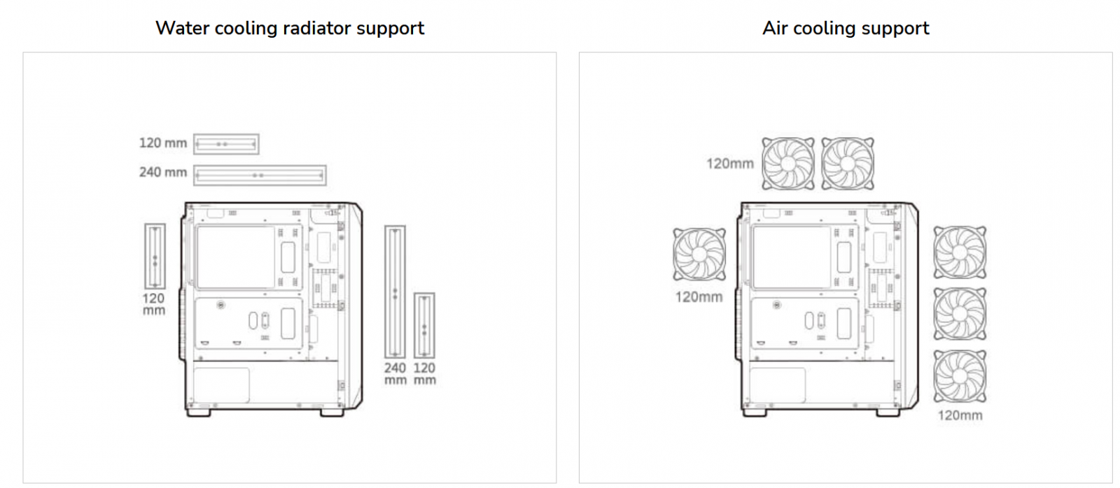

What CPU Air Cooler or Water Cooler ( AIO) which fits only 120mmRAD & 65mm clearance for air cooler by my Cougar MX410 G RGB case ?
I am thinking regarding air cooler : Coolermaster Hyper 212 LED Turbo ARGB
While regarding Water Cooler(AIO) :
Coolermaster Masterliquid ML120L RGB or
Deepcool Gammax L120 V2 RGB
Which one of the above coolers should I opt for my above case?

I personally like Air Coolers and not AIO, though a lot of my friend opted for the AIO from NZXT. I have heard that they are more reliable.

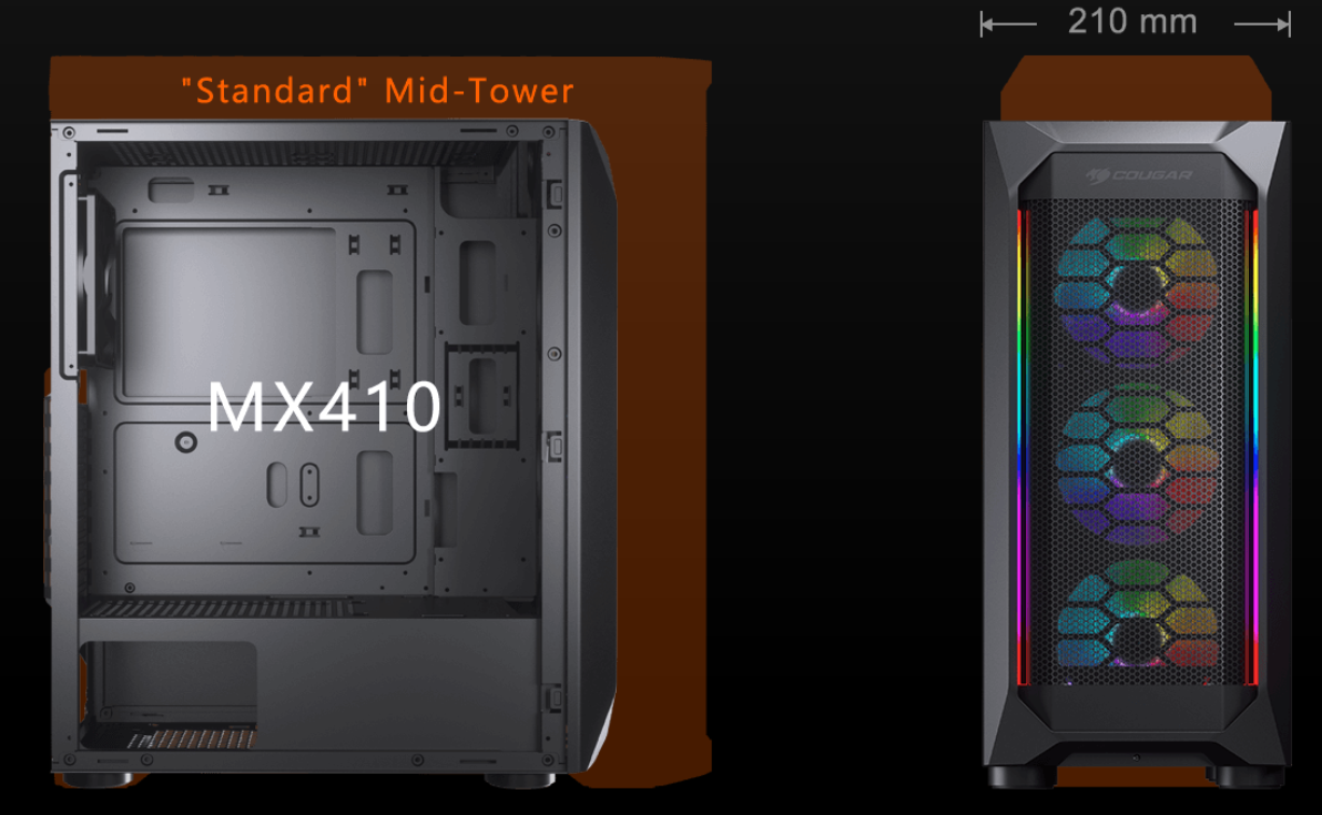

Isn't your tower 210 mm Wide, it should be able to accommodate a bigger air-cooler. And why a 120mm AIO, why not a 240mm ?
It's not the dimensions it's not fitting with the motherboard installed into the case as the ram sticks are obstructing the 240mm rad aio
That's why I am asking about 120mm aio or air cooler.
