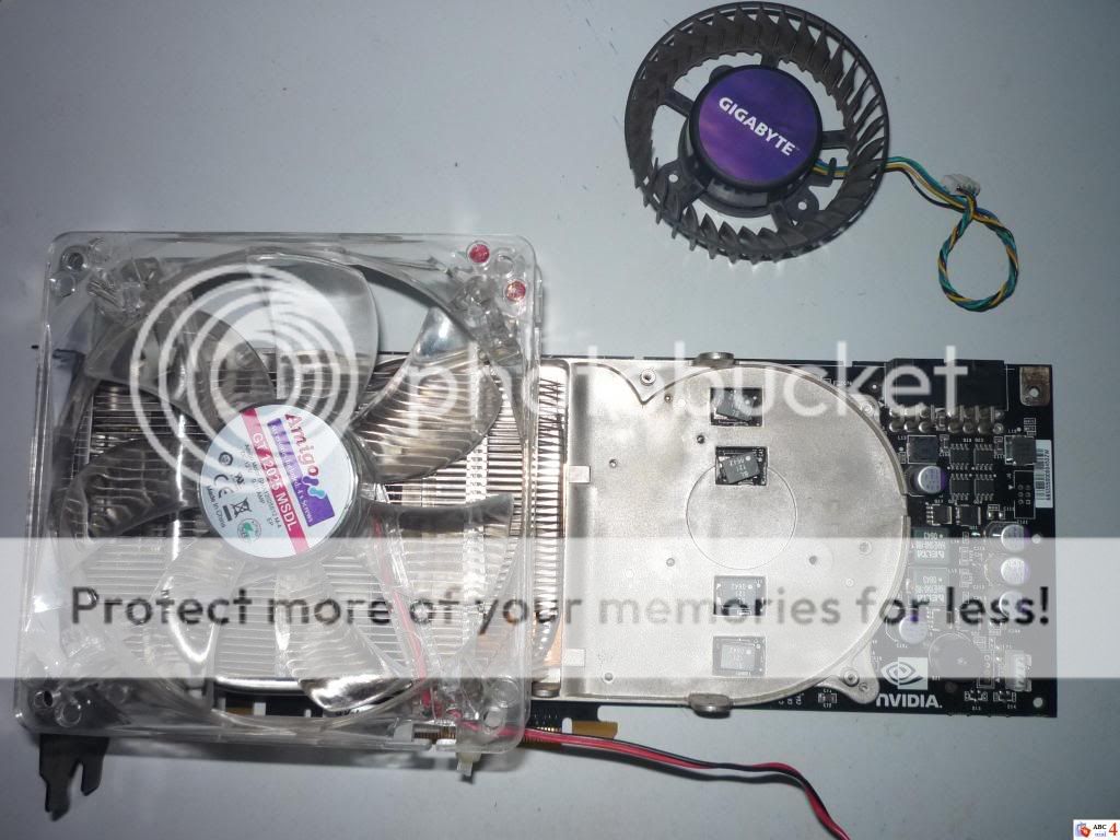

If putting fan in it's place does not work, you can try this ghetto method:
-Remove the shroud.
-Attach external fan using tags/ties.
Here is pic for reference:
Me and many TE members have done this small mod to their cards. I have attached that 120mm fan on my 8800GTX for better cooling. Yes, it performs better than stock(Reference design). Yours is not a reference design, performance improvement is what we are unsure of. Then again you can try attaching two fans to improve performance or single 120mm fan might perform better.
-Remove the shroud.

Thanks for the help guys, I tried to fix the fan but I could not, at last I used some zip ties and put two 80 mm fans works like a charm
