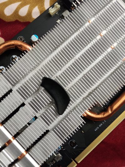

Found the missing fan blade. Removed the shroud to try a noctua fan and found the blade stuck inside. What can mend the broken blade? superglue i guess, or something else?.
You can try glue gun or fevikwik but just remove it totally as you're going to put a noctua on it it'll be much cooler than stock ones.
