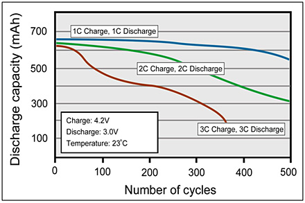

To quote:
Apply the ultra-fast charge only when necessary. A well-designed ultra-fast charger should have charge-time selection to give the user the option to choose the least stressful charge for the time allotted. Figure 2 compares the cycle life of a typical lithium-ion battery when charged and discharged at 1C, 2C and 3C rates. The longevity can further be prolonged by charging and discharging below 1C; 0.8C is the recommended rate.
Cycle performance of Li-ion with 1C, 2C and 3C charge and discharge
Figure 2: Cycle performance of Li-ion with 1C, 2C and 3C charge and discharge.
Charging and discharging Li-ion above 1C reduces service life. Use a slower charge and discharge if possible. This rule applies to most batteries.
