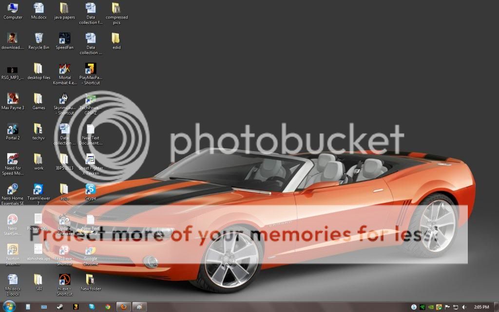

Hi people I hope someone can help me out with the problem... My brother has just upgraded his GPU Zotac GTX 560 and he is getting a problem the display is not
CRYSTAL CLEAR and CRISPY as it should be after applying the GPU.. updated the drivers and installed but nothing has changed.... same dullish screen and icons as if it has no GPU installed... So please help me with this problem.... is this the issue with the GPU or driver issue?I really cant make out what the problem is so please HELP !!!!!! I am also uploading a screenshot along.....
please help me guys no one out here ever faced same kind f problem?

You say that, but you posted a screenshot? Screenshots are generated by software and not hardware. If your screen resolution is set to 640x480 and your monitor is 1920x1080, the screenshot will be in 640x480, and with the correct aspect ratio - your display will however be all blurred and stretchy. If you are not a 'NOOB', you should know that.
You need a good high resolution photo (taken from a good camera that is not blurry) to be able to explain the problem. On top of everything you have a wallpaper image which is 4:3 and it has been stretched to 16:10 hence the first thought that everyone has is that your resolution setting is incorrect.
Now, to your issue. Without a picture of the problem (or your ability to lucidly explain the issue) is difficult to diagnose. However it seems the adapter could be a source of some issues. It would be wise to try a digital output connected to a digital input on the monitor (and we have no clue to which monitor you are using and whether it has such an input). One assumes that maybe a DVI or HDMI input is not available on your monitor. In cards with two DVI outputs, only one is convertible to VGA, not both. It would be wise to consult which output is to be used for the converter.
In any case, a blurry and dull picture is par for the course with analog, even when the resolutions on the adapter and display match. All bets are off with converters, even ones packaged with cards.
