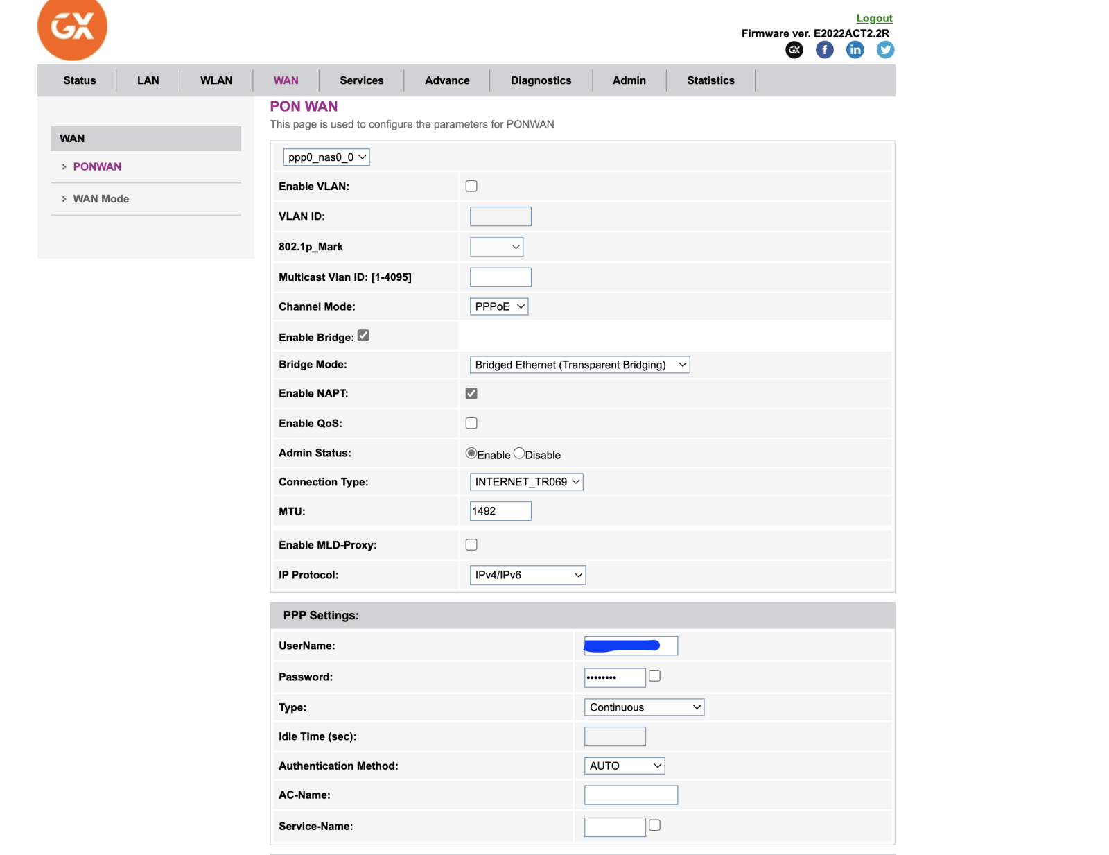

3. Open Admin page and go to wan settings and typically you will find the following configuration
4. Change options to following
  1. select 'nas0_0' (this is the default profile created with connection type set as INTERNET_TR69 - it is ok to use it)
  2. Select settings as shown in the screenshot below
    1. Exact settings :
      1. VLAN = checked
      2. 802.1p_mark = 0
      3. Multicase Vlan id = empty
      4. Channel Mode = Bridged
      5. Bridge Mode = Bridged Ethernet (Transparent Bridging)
      6. Enable NAPT = unchecked
      7. Enable QOS = unchecked
      8. Admin Status = Enable
      9. Connection Type = INTERNET
      10. Enable IGMP Proxy = unchecked
      11. Enable MLD Proxy = unchecked

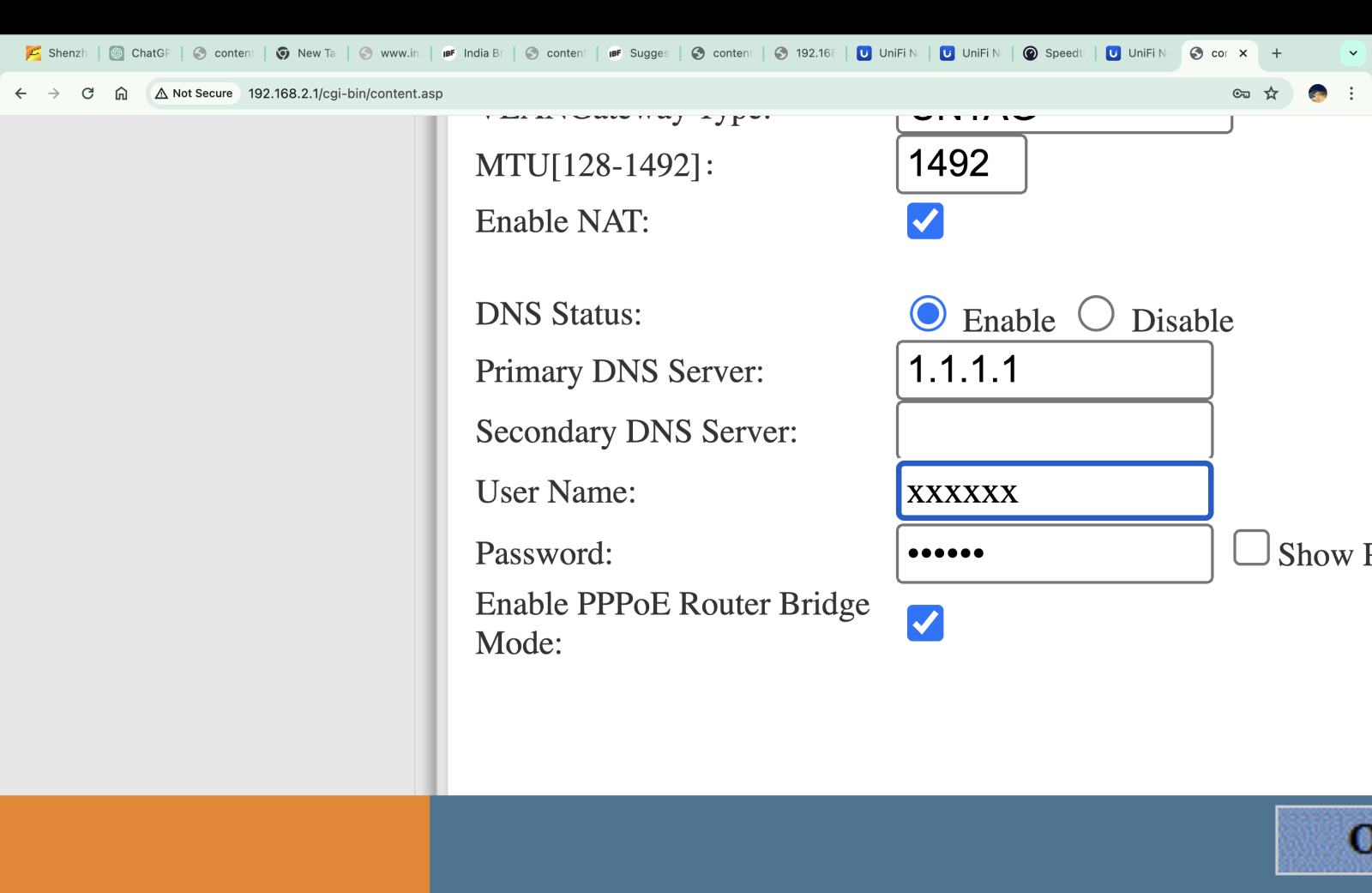

I have the Titanium 2122A from Airtel. All I had to do is switch the Internet connection's gateway type to Bridge from Route mode. Keep everything unchecked below, select PPPoE bridge as bridge mode. Post a screenshot of your router's WAN page if needed.
An additional trick you can do is put the OPON on a different subnet than your main net. That way if your main router supports dual IP PPPoE (TP Link does) you can continue to access the OPON even though it is in bridge mode.
