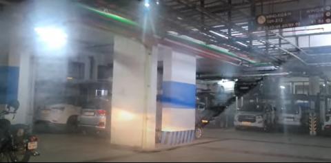

When driving in rains esp. during late evenings and night times I'm facing the usual hazy/foggy issue on my cars windshield.
The issue is severe at the left side than right and is happening to many cars- cars stuck in traffic, friends, families etc.
I did whatever Rnd I could and the haziness i mostly occurring inside/within the windshield is what I feel.
In standstill traffic, I saw drivers or the co-passengers stepping out of their cars trying to wipe off the fog and once in, the effect returns instantly. I too tried to wipe with a cloth from inside and it could not be wiped even 1% as it was not from inside. When I used vipers, it did help reduce the haze but only by 20% or so but not fully or to the max.
Its rather confusing as to whats the effect and where it is occurring as I'm 110% sure its not happening inside else using cloth I could have been able to wipe at least 1% of the fogginess!
**This issue somewhat also contributes towards traffic jams as well as one cannot judge the left-side and tries to maintain too much of a distance.
While I do not have a doubt about the functionality of AC, front and rear defoggers and blowers as they all are working just fine, I'm in search of the best combination of rain settings which can either get rid off this annoyance or at the most, considerably minimize to the best possible levels helping driving comfortably!
Its a struggle many of us face/and are facing since years across many car brands be it wagon r or a fortuner, yet everyone just keeps experimenting with the settings while not knowing which settings work guaranteed.
Even people on the almighty Teambhp aren't spared aka facing this issue.
Another issue of water gathering on all 4 passenger windows along with fog though it goes off with AC but a few solutions for that as well would be appreciated.
There are few products and methods available but I would primarily like to stick to the in-car air flow settings which should get rid of this annoyance naturally as thats how every car is designed with exceptions of a rear-viper.
--Thus, looking for a a single, simpler tried and tested technique which works across cars!
What was the temperature of your AC when you took this picture?

27-28c. Few suggested to use heater and not AC and bump it to the max 32c..haven't tried that yet.

The car's AC is the problem as well as the solution to OP's problem.
Fogging on inside/outside of windshield, near the vents only (bottom of windshield):​
  • The AC temp is set too low. The glass has become so cold that moisture is condensing on the cold parts near the vents
  • Raise the AC temp to around the ambient/outside temp +/- 1°C (technically it should be above the dewpoint, which depends on temp + Relative Humidity, but external temp is a good/fast estimate)
If there is heavy fogging in a stopped car (AC off), use "Turbo Mode".
It works best once the engine is warm, since the heat comes from the engine coolant. If you had parked overnight and the engine is cold, this method won't work, so let the engine warm up first
  • Crack open windows
  • AC on
  • External air intake (i.e Recirculation off)
  • Temp to highest setting
  • Fan on Max speed
  • Airflow to Windshield vents
  • This should clear up the glass in seconds
Once the glass is clear, you can lower the temp to a more comfortable range, and redirect the airflow towards yourself aka Regular AC usage. For reference:
On warm nights I set temp to Ambient - 1 °C, airflow to face + feet, Fan on Auto, which will usually spin at lowest speed)
On cold nights I set temp to Ambient + 1 °C, airflow to face + feet, Fan on Auto, which will usually spin at lowest speed)
If you observe condensation slowly forming near the vents, simply increase the temp a notch.
Never switch off AC in rain/high humidity conditions: else the glass will fog up.
Fogging on outside of windshield, over a wider area:​
This may not actually be due to condensation at all, it could be:
  1. Streaking, where the wiper blades are old and leave behind a film of water. Replace wiper blades
  2. The washer fluid is too soapy, so it is leaving behind a translucent film: don't add too much soap concentrate to the reservoir. It should leave no residue at all
  3. The glass is extremely dirty with oily residue: wash it properly with soap + water, finish with IPA
  4. If none of the above works, your glass might have scratches that trap water, or scaling from hard water, in which case it might be easier to replace the windshield itself
In the TBHP link above, the haze pattern changes when the wiper moves over it, indicating it's on the outer surface.
