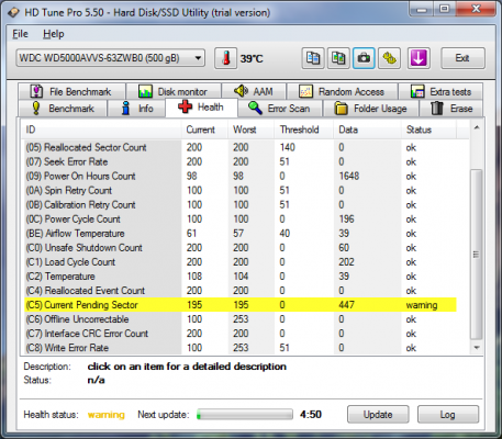

Hey Everyone i was worried and made a check.And thats what Health check appear? Is my hard Falling or something please repsond fast

u guys sure that there is no problem????? u sure that my hard is not falling apart?[DOUBLEPOST=1378051149][/DOUBLEPOST]Here is Crystal DiskInfo need respond fast guys please

Through your command prompt, run "chkdsk /f" so it marks the pending sectors as bad. 447 sectors does seem a bit high, but depends on the age of the disk. Keep monitoring the disk and if this value is increasing rapidly, its time to backup and replace your drive.

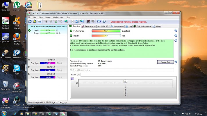

I Would like also to Show u guys These picture from HDD sentinel but what i see is the health is 52% and it is fair? So that is good or bad?
This is a Western Digital Drive right?
If yes , then backup your Data and RMA the drive.
