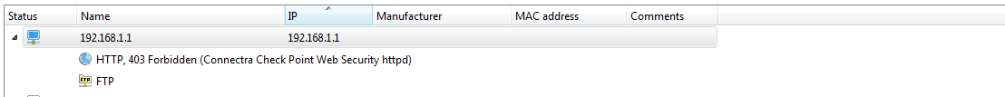

Something has to do at BSNL's end. It is wrong configuration from BSNL.
**probably they are running some services on that particular node. it is routing inside BSNLs network. of course it is non routable over internet address.
*** it is checkpoint connectra websecurity gateway.
Looking at the traceroutes, its evident that the IPs are on BSNLs end, mostly done for some services. By default, most people use 192.168.1.1 for the internal IP, hence that IP would be non routable mostly.
However, what BSNL is doing is wrong, its a violation of IETF RFCs which say these should be non routable from the internet.[DOUBLEPOST=1508305980][/DOUBLEPOST]
F*** I guess someone has no brains and done a quick hack to get them working without realising that these will be routable from the net.
