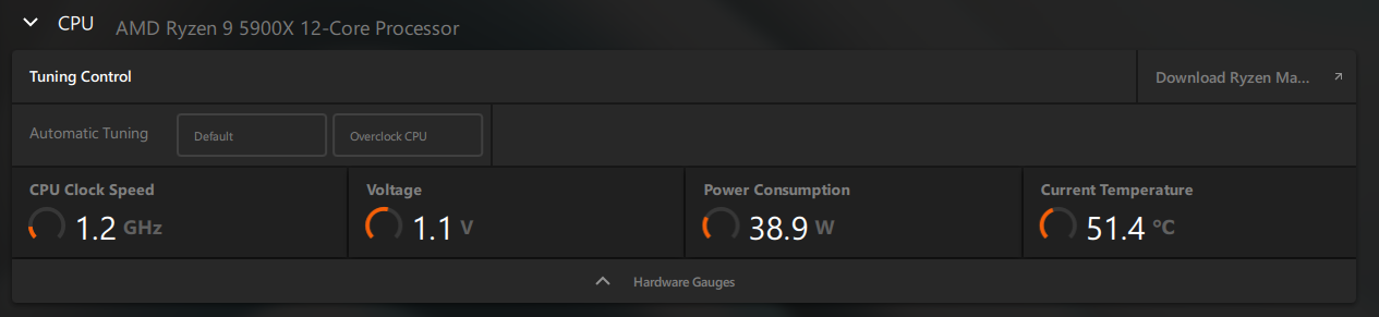

try the power saving option when on desktop mode. My 5600x sits on 2.2 Ghz than 4.2 Ghz and hence is on lower temps and saves electricity as well.

not relevant. I am on 4.2ghz oc on all cores. but normally its 1.7 or 2.2 or anything lower ( 0.3mhz is the least I have seen ). it is done by amd automatically. why manually change it ?

Any specific option to tweak in Power saving mode or you selected the mode with all defaults..
the above is when my youtube is one and I am also working and plus I was posting on this thread :p
What tool is this?

What tool is this?
by default only. thats ryzen master

Its by default. Ive never seen it go lower than 2.2 . Maybe Im missing something in power saver settings or in bios.
How did you manage to go so low or is it by default ?
MIne too always stays stock @1.7ghz if I enable power saving mode and it lags a bit so switched back to my custom setting profile.
I too thought but it isnt even if its written..may be themed version.
This is how Ryzen master looks usually.. and no theme change option as well.
