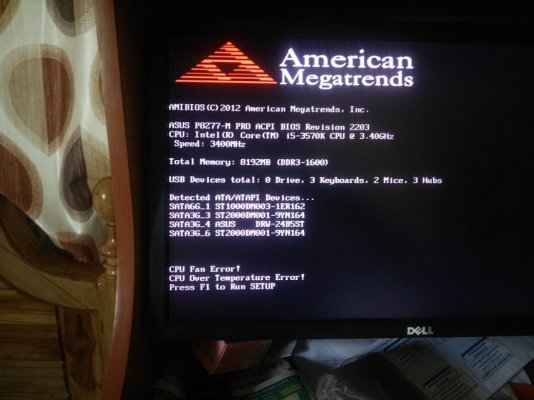

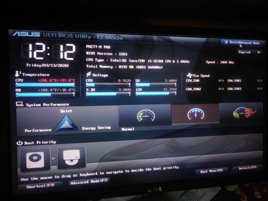

I am getting these errors. I have posted the screenshot. How do I fix this? I bought this entire system in 2012. So this is the 1st time I am receiving this message after so many years. My tech also comes once in every 4 months to clean up my entire system. So 3 times cleaning up of system in a year is done.

open the side panel and check if the CPU fan is spinning. if its not spinning, replace it
Which cpu cooler you are using now? 97`C is too much for 3rd gen processor. if you are using stock cooler, replace it with a good after market cooler, also you may need to reapply thermal paste.

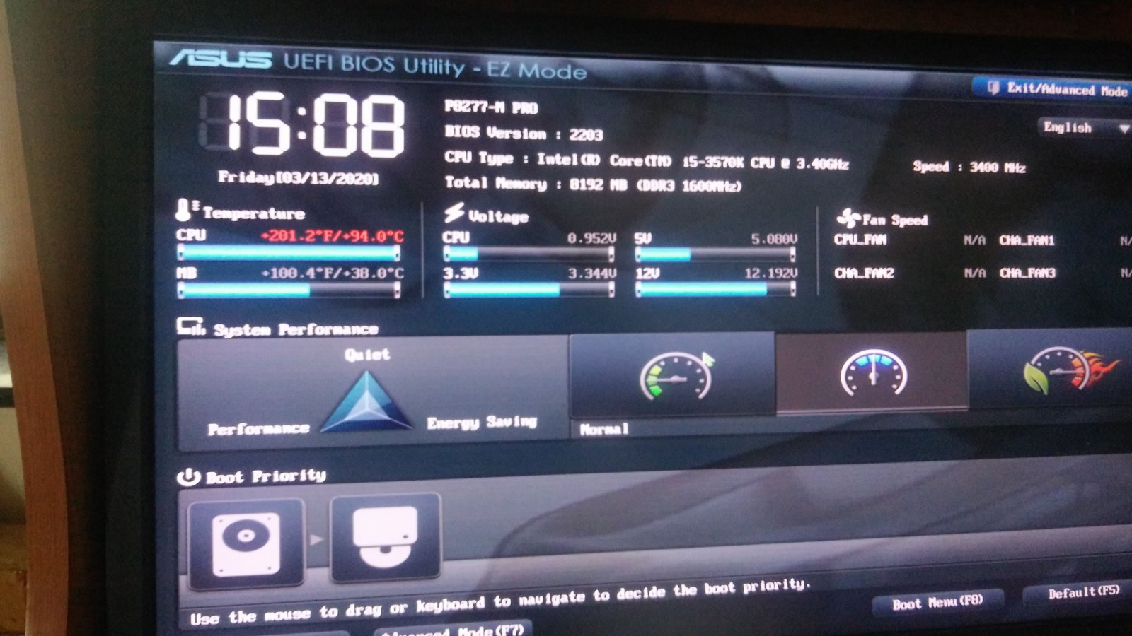

I don't know wht is stock cooler. After I got this error I installed Windows 10 now. I thought May be Windows 7 os service is over that most be causing the issue so installed Windows 10 Os now n after it reboots it gives me the same message on display n then it goes to setup screen n nothing else after that. This is the screenshot now after installing Windows 10 os just a few mins ago

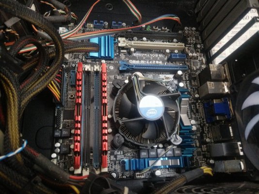

Can you post some pics with side panel open. As suggested by @SunnyBoi have you checked whether cpu fan is spinning or not.?
7 years without changing el-cheapo thermal paste is too much.
Thermal paste is what you put on top of the CPU and then the cooler on top of it to ensure thermal transfer from the CPU to the cooler.
Stock cooler is the piddly tiny cooler you get with your Intel CPU by default. Aftermarket coolers are what you use to replace the crappy Intel stock cooler for better cooling/lower noise.
SInce its like a gel it dries up over time. First of all check if your CPU cooler fan is working or not as pointed out by @SunnyBoi.

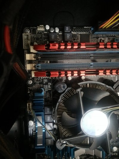

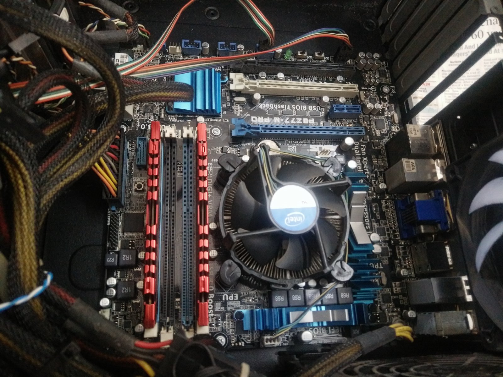

Cpu can is not working after I connect the power cable n removed all other cables n saw. I am attaching the screenshot. Jus check if my tech has connected the cpu fan plug to the correct pin or not. So I m posting 2 pics
Which cables did you remove ? If you press the power button is the PC tryng to turn on at all?
From what I could see the CPU fan seems to be connected correctly.

Since you are using k series processor with z series motherboard, it's better to go with liquid cooling, if not then CM hyper 212 is a must. Also your RAM placement needs to be corrected, since you are using 2 sticks place it in 1st & 3rd or 2nd & 4th slot for better dual channel. Regarding blower I'm now also using a 15yr old Eureka Forbes handy vacuum + blower without a single repair.
