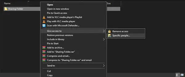

Thanks after following this method, two computers and their drives are detected on each other in the network . But the problem is i m not able to access the folders. I turned off password protection, I changed the permission to allow to all the drives and also to all the users. But no luck. Is there any place I have to sync the password between the two computers like I did in the old homegroup version of windows?
I think you wouldn't be able to access files folders with password protection disabled. I found this issue on my home PC's. One running Windows 10 and another Windows 7. The only way I could gain access to shared folders were to enable password for the user account of the networked PC. I think with recent Windows updates accessing network shares without a password is restricted as it is a security risk.
When you try to access the shared folder Windows will prompt you for user name and password. You should enter account user name and password of the networked PC you are trying to access folder of. Windows I think will also save that user name and password so that the next sessions will be automatically logged in.
Are you using
Oh yea I faced this as well. You need to disable pin and any other log in methods you have, a dn use just password. Then see if you can see the files and folders
