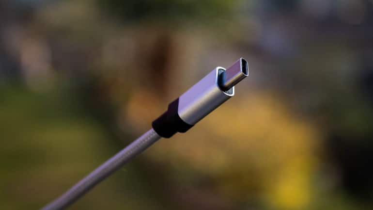

India makes USB Type-C charging mandatory for device makers from March 2025
