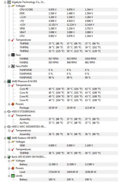

On monitoring the temps i found it to be 38 deg normal.

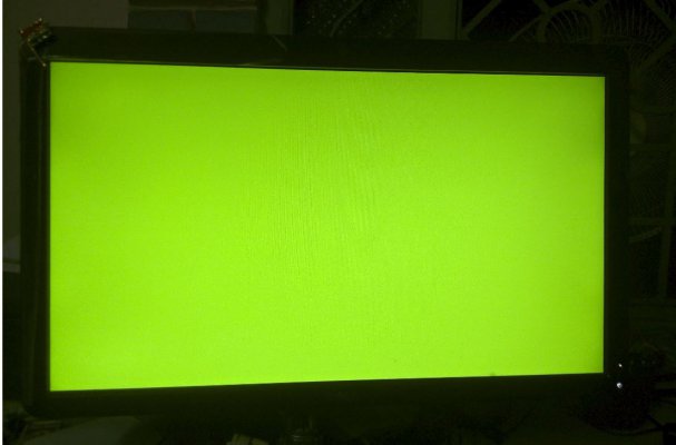

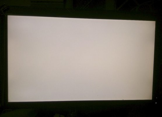

Done a colour TEST in monitor. No issue

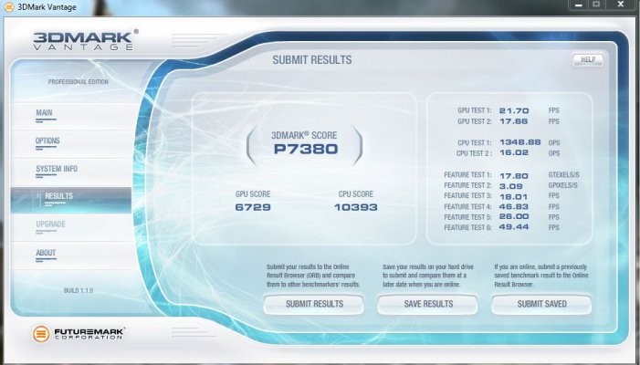

Done 3dmark TEST. Does it indicate anywhere any anomaly?

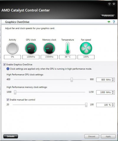

The other GPU info:

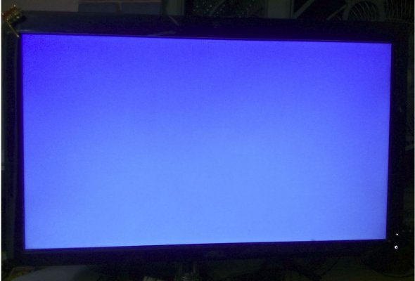

Yesterday while watching a movie it crashed. Watch this :

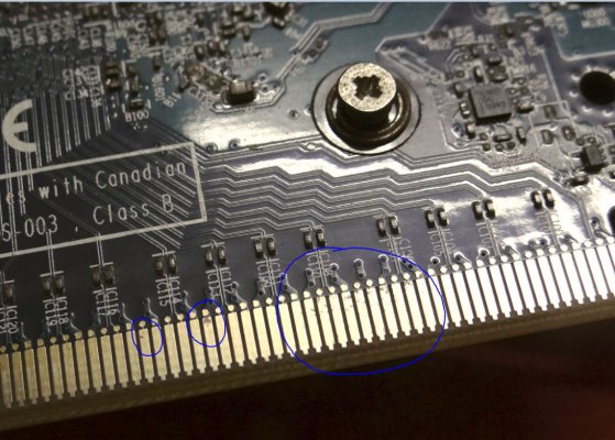

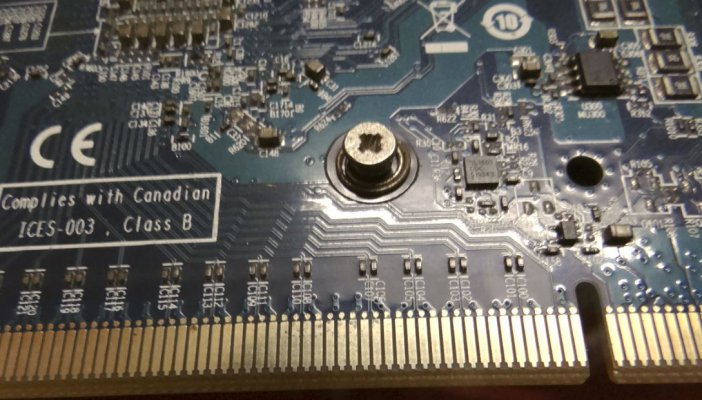

Today i have opened the GPU, unplugged DVI cable and fixed VGA . Cleaned the PCIE slot and then while cleaning the GPU i found this:
