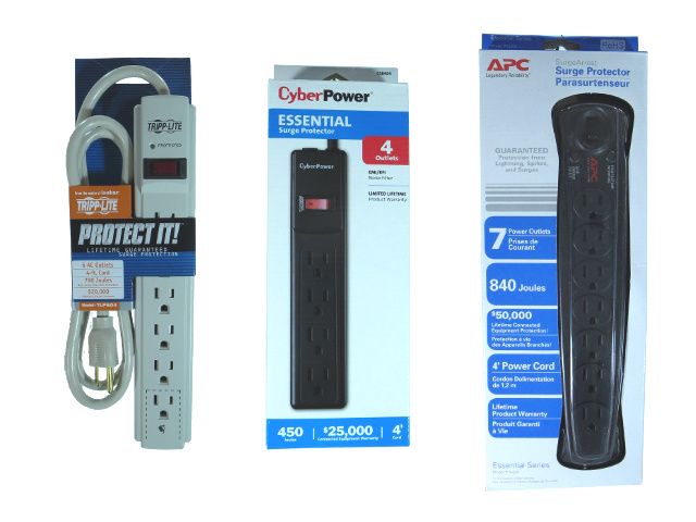

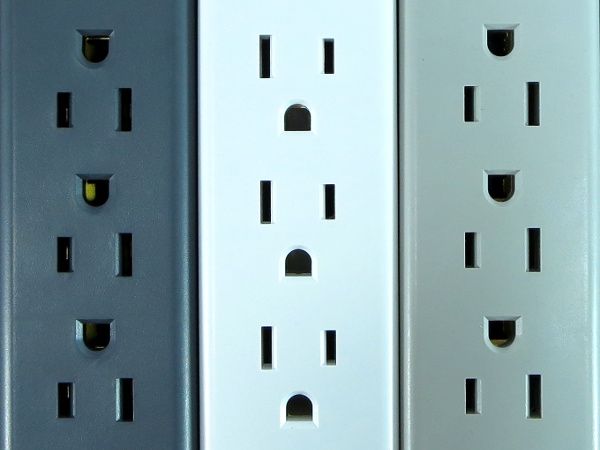

This is a very basic model, it probably doesn't even have a basic MOV. Shouldn't be an issue.
"Many power strips have basic surge protection built in; these are typically clearly labeled as such. However, in unregulated countries there are power strips labelled as "surge" or "spike" protectors that only have a capacitor or RFI circuit (or nothing) that do not provide true (or any) spike protection."
Tom's has done some very detailed teardowns and testing of power strip. Good read even just for the heck of it.

Wow! Those were really interesting articles. Quite entertaining at times too :D

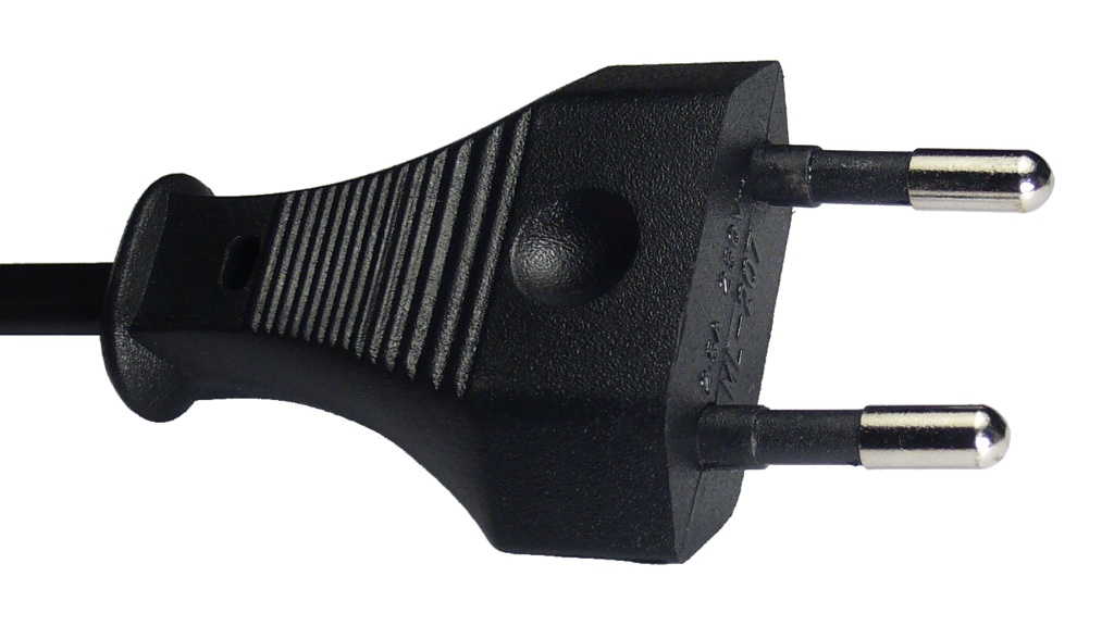

Really?! I've used 3 power strips/surge protectors so far in my life and my speaker plug, modem, router adapters always fit very loosely in every one of them. But that's more due to the thin pins on the plugs and not because of the strips being of poor quality or anything.
Greyfalcon
Member
Oh yeah! I think I saw one of these conversion plugs fitted onto the old speaker plugs a long time ago when i was a kid. God knows where that thing went.
Thanks for reminding me of this. Its pretty irritating when the speaker keeps losing power and i have to keep fiddling with plug to get it to work again.
Might buy a couple. Or....might call it a jugaad and look away. After all I'm an Indian.
