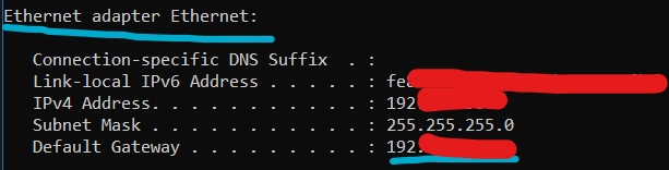

Here the IP is your router's IP. If you're not sure of that, before running the ping command run "ipconfig" and look for the default gateway, like here
