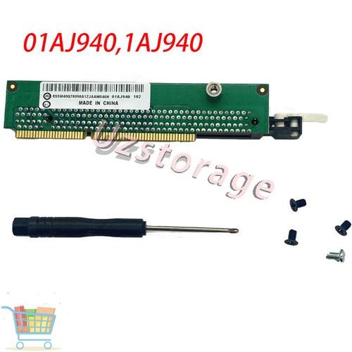

If I am not mistaken, this has a pcie slot just below the HDD cage so one can use a riser to install a NIC card. You may need to let go of usage of the HDD space though.
But better to check in the Lenovo forums once.
Indeed. There is a very slim pci-e slot, don't know if there is a drop-in nic solution available.
If you can arrange for the pcie riser :-
Any half height, single slot card would work.

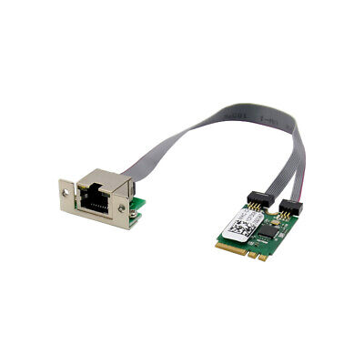

You can loose the wifi slot in lue of :-

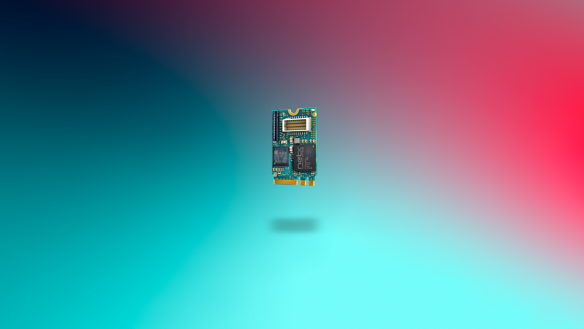

Or dual gigabit lan:-
