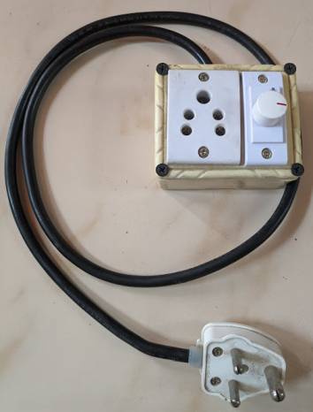

I have a big a$$ cooler crompton optimus 100L in my room and I have made it very silent. I wish I had seen thread before. Would have saved money for you.
No worries, we needed two coolers anyway and this one is for when I am WFH. Do share how you made it silent though as others would benefit from the same and, if feasible, I could definitely use that to silence the B52 Crompton bomber.
It's very simple. See, how you use fan regulator to control ceiling fan? Same principle here. Only I'm using dimmer instead of a fan regulator.
I made this extension 6 years ago only for silencing the coolers. Dimmer controls the fan speed. If you go to local shops to buy dimmer they try to sell you fan regulator. Both look same but operate differently.
This has made the fan of my cooler inaudible but hasn't affected cooling a bit.
So essentially you are able to use this and decrease the fan speed to much lower than what the cooler fan regulator can do. Based on how dimmers work, isn't this risky to the fan motor and the water pump ? Why not change the default cooler fan regulator with an electronic step type regulator instead ?
I haven't faced any issue. Dimmer is rated for upto 450W whereas my big cooler doesn't pull more than 160W. About water pump, it's unbothered about it. It keeps pumping same amount of water no matter where the dimmer is set.
About the answer from the link, the dude is wrong suggesting lights are resistive load. Most light sources we use like CFL and LED are inductive.
Because,
1. Warranty
2. Last cooler I opened I found, for every step on the fan regulator there's a seperate wire that goes to the motor. It's complicated.
3. Why complicate things when there's a simple plug n play solution that's working for me for so many years?
Because,
1. Warranty
Thanks. I will try this hack next summer, in any case the cooler is out of warranty.
