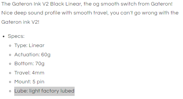

Also, just ignore my comment. Will be better for me.

The site is wrong. Light factory lube was never applied on V2 Inks. Only the leaf got a light lube, which all switches do. Factory Lubed switches usually have oil/grease on the spring/stem. That is what reduces scratch, not a slight lube of the leaf.
Also, this comes from actually owning several pairs of Ink V2's and opening them up, not checking Meckeys site, which is wildly inaccurate. Hell they even call their China FEMO Connectors as Original LEMO. Please take anything thats up on that site with a large pinch of salt.
Also, if you give out incorrect information, its easier to not ignore it and correct it for the OP.

The screenshot isn't from Meckeys. Actually, Meckeys do not even disclose if Ink V2 Black is factory-lubed.
Gateron's own website mentions that the V2 Black, Red, and Yellow come factory-lubed. Only the the Ink V2 Blue comes unlubed.

Read again what i wrote, the nomenclature for "slightly lubed" by factory is NOT lubing as you would call it. It is an oil that is applied to the leaf of the switch to reduce corrosion. When you say Lubed/Unlubed or Lubed Switches that is Oil/Grease on the STEM and RAILS of the switch, as well as the springs sometime.
It's okay, you're clearly a beginner in the hobby, so i suggest you take some time delving deeper into it before commenting :)
