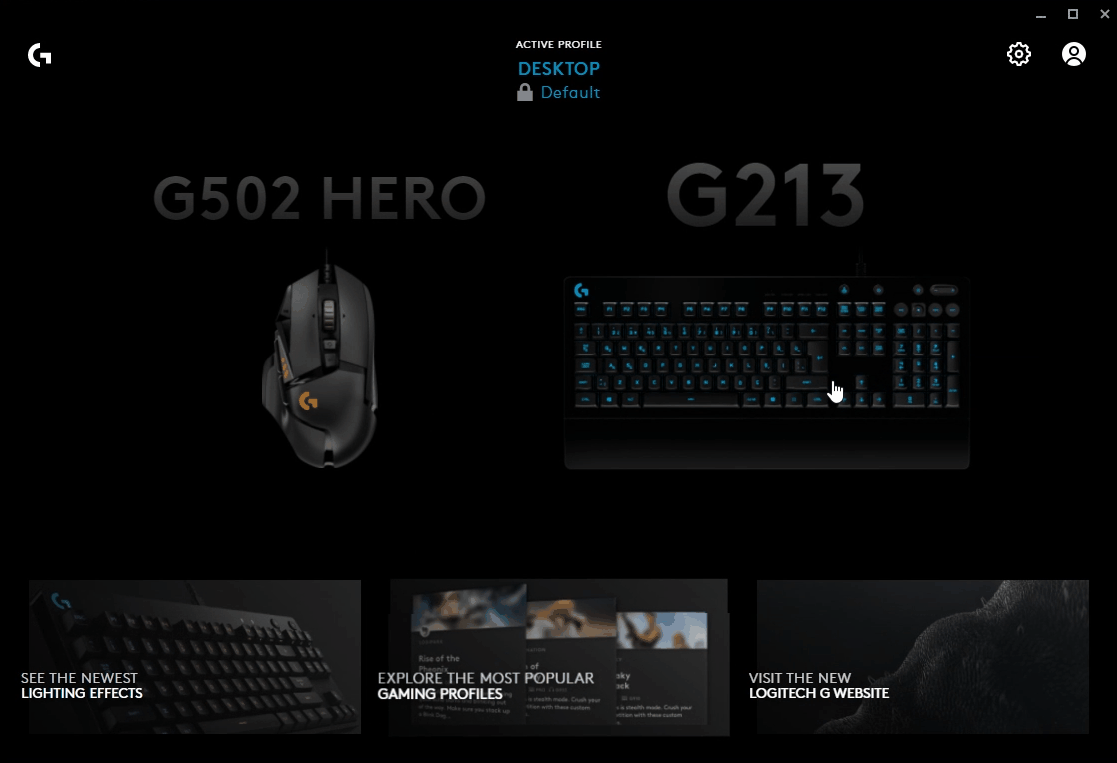

1. Open Logitech G Hub app. Goto Manage profile in the dropdown as in the image.
2. In profiles, select the Scripting icon.
3. Rename the script to anything as required (I named it left click). Paste the code as in the image. Save and Run under Script dropdown. 90% job done.

After all this is done, disable your left click like mine was disabled in the first image.
(IF THIS IS NOT DONE THEN EVERY LEFT CLICK WILL REGISTER AS TWO CLICKS. ONE FROM CODE AND ONE DEFAULT)
