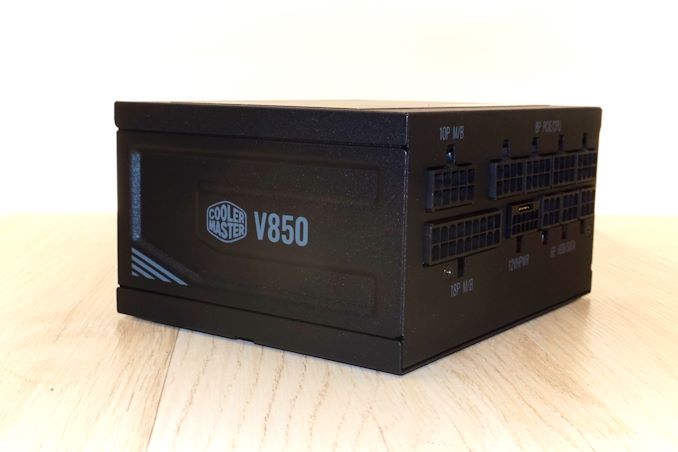

The EPS connector melted, the ryzen 5900x has max tdp of 105w, even with that maybe a loose wire, or incorrectly(what I personally feel) terminated wire terminal caused arcing and hence the heating and failure. And when it comes to taking responsibilities, companies do have a habit to blame some other reason.
What CM said- 5900x and 3080ti are top of range components and shouldn't be used for itx builds.
Ok then why is 5900x on the official compatibility list for the b550i
Other argument, 3080ti has transient power surges which can cause this rail to receive more power, in that case, such surges actually cause the PC to turn off. Not cause a failure like this.
There is other safety features build into the board as well as the PSU, but in this case they didn't behave in the way they should've, for that there is no answer. So if a failure like this happens, it doesn't matter if you did everything right, it still depends on companies if they want to do right by you, because they will come up with an excuse not to do anything about it because they will lose money over it.

Just adding 2 cents. Imo, the Psu completely at fault here. Not the temperature, not the motherboard.
Cause usually it's the Power supply which causes such burns.
And moreover what i read online, CM 850 is notorious for sending ripples to the motherboard.
However, the Over Current Protection (OCP) settings are a bit lax on the 12V rail, at 130%. The Over Power Protection (OPP), measured under hot conditions, shows a setting of 124%. These figures may actually seem low for an ATX 3.0-compliant unit, but technically are high considering the thermal stress this unit receives.

Totally true. Corsair SF750 is wayyyyyyy better than CM 850. People have compared the later to garbage TBH.
Older CM psu's were very good these newer ones don't do justice to the brand or the brand is not doing justice with itself by not making good psu's anymore. In last 3-4 yrs i have found gigabyte psu's to be more reliable then CM even though gigabyte was embroiled in a psu blast controversy.

My hypothesis
Somewhere something was shorted, which made the connector pull huge amount of current. Maybe something touched your motherboard at place where it is not suppose to be ground which resulted in contact with chassis ground.
Since it is an itx clearances will always be an issue. Vibrations and heat can make things expand slightly, which might be enough to touch something somewhere.
