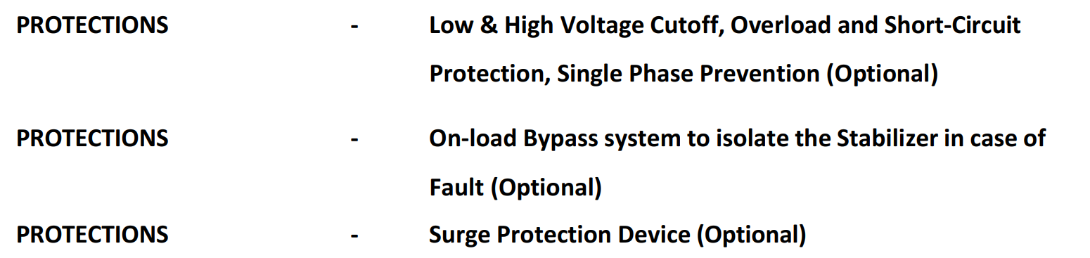

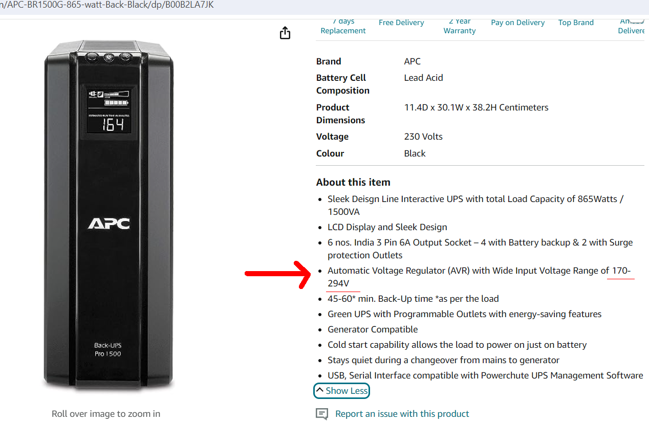

Please note: UPS wont handle voltage fluctuations very well. This is the misconception many people have.
Even a Rs. 17000 UPS from APC which has a AVR (automatic Voltage regulator) feature built-in (not present in normal UPS) is just rated for 170-295v which is not good.
In India we easily see voltages between 140volt-330volt (We have electrical business, and have data of many households)
