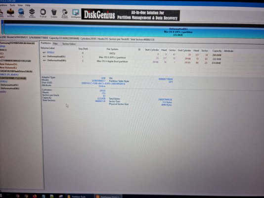

These are the partitions that i want get rid of , i am trying to delete it , it gives me an error stating unable to complete the operation , same thing happens if i try to reformat it . Only disk genius was able to identify the partitions , other bootable partition tools simply wont recognize it

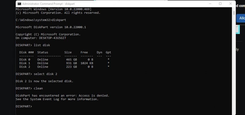

Got access denied while formating in Diskpart .........

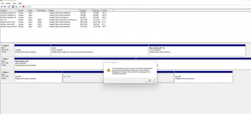

While formatting in disk management this the error that i am getting .........

@Ankit2306
Kindly share the output of the following command after selecting the target disk in diskpart:
Code:
attributes disk
On another note, are you using some kind of SATA to USB adapter to connect the disk to your PC?
Gotcha, the clue is present in the first screenshot. See that "SATAFIRMS11" tag on the SSD? It's there because the Phison controller of the SSD is borked. Depending on the current state, it might be possible to repair it by reinstalling the controller firmware.
Before attempting the flashing job, make sure to note down the exact IDs of the controller and the NAND flash of your SSD. In case the SSD in question is still under warranty, it is better to opt for RMA.

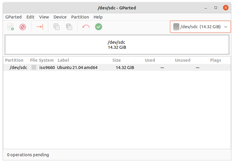

Okay, I am assuming that you know how to create a boot disk using rufus/unetbootin etc...
I am showing this using ubuntu 21.10 because the image has all the required tools that you would need.
when you boot the usb key and connect the kingston hdd, you will see it in the gparted gui tool. something like this...
you will need the device name from the above screen on the title bar. for example in the above screen you have /dev/sdc (sdc is the drive and sdc1 etc... are partitions.)

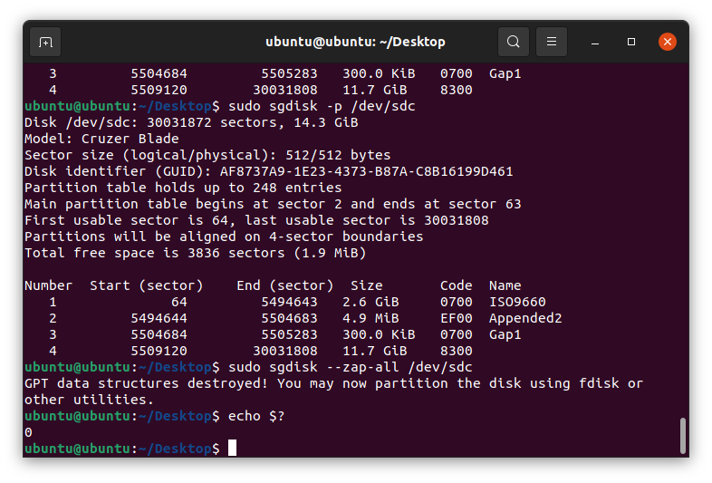

now what we need to do is zap the disk. basically write zeros where the gpt/mbr partition tables are... this can be done with a dd command line tool but there is a easier way. i.e., sgdisk --zap-all; sgdisk -p /dev/sdc will give you information about the disk before you destroy it.
to execute the command, you open terminal and type
Bash:
sudo sgdisk --zap-all /dev/sdc
sync
Thats it.
if you want to know if the above commands succeeded; type "echo $?" after each command to know the return code. a zero return code means success.
isn't this the same as running clean using diskpart? if the controller is ****ed like titokhan mentioned, this probably won't work either right?
I don’t think the controller is ****ed. But yeah, if controller is gone then it’s better to rma.
On the part about being same as diskkpart; i honestly don’t know. But sg3tools work by issuing scsi commands and not the regular read/write ioctls. Which means they work at a lower level in the driver stack.

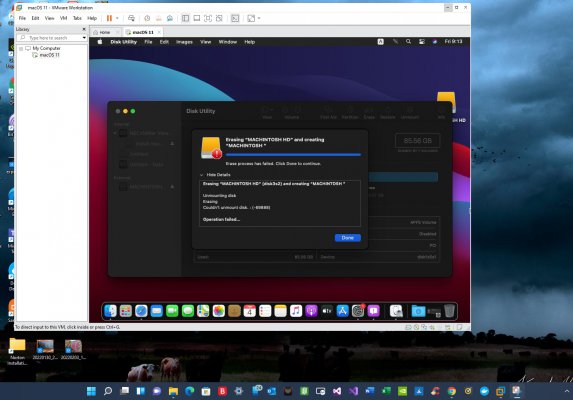

If you think macos is able to format it, you can try enabling hot plugging in the bios and format it on a macos Virtual Machine.
This is the error i received while formatting the drive mac os running in Vmware
