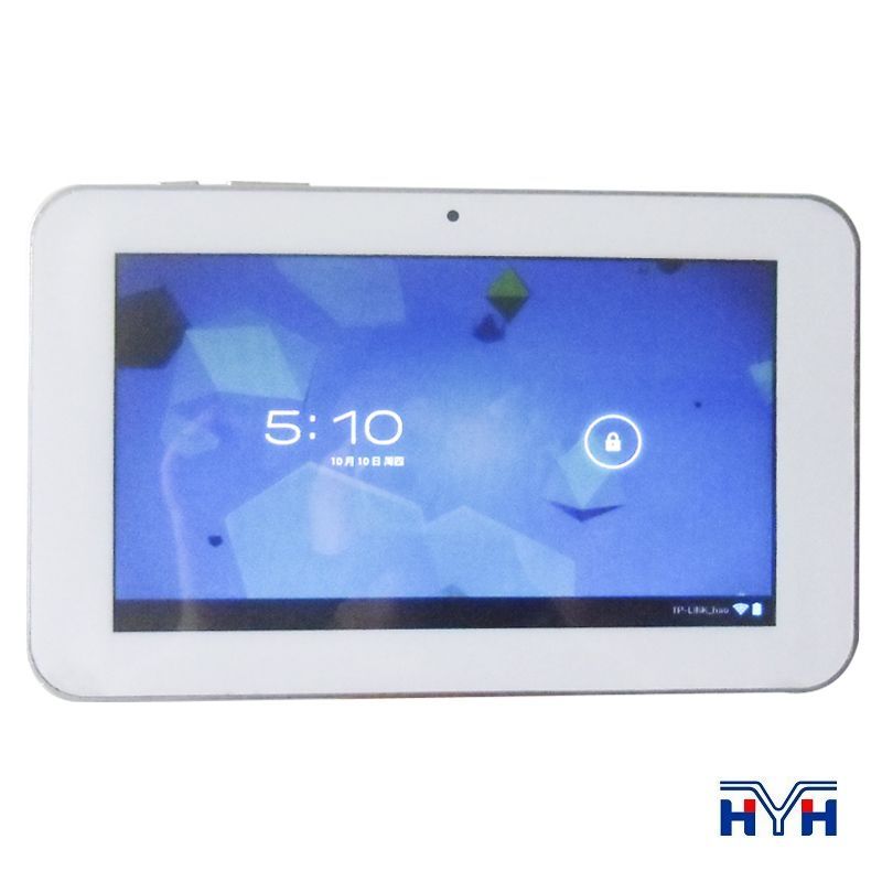

Would you be a bit more specific as to the Model and make of the Tab ? That surely will help
Are you referring to this model ?
It looks something like that sort. A chinese tablet with some importer name on the tablet like tech point or something.
