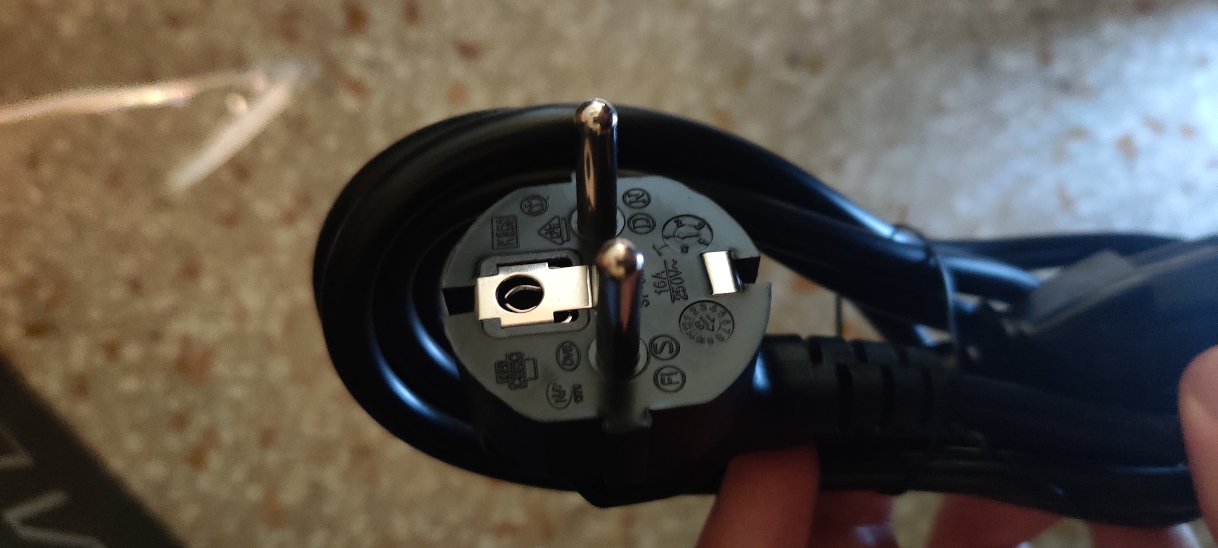

I bought XPG Core Reactor 750W (Gold) and after I plug everything, my fans and case light turn on for half a second and after that PSU gives one click sound and PC doesn't boot up.
My PSU came with German/French outlet, it looks like this:
I used my corsair UK outlet because my surge protector has Indian/EU pins. It looks like this:
French/German outlet is rated 16A 250V and UK outlet is rated 13A 250V.
Is my PSU faulty or is it because of the power outlet, I know that both outlets are within spec and shouldn't cause any issue.
Just to make sure that PSU is the culprit I even plugged in French outlet and same thing happened.
Sucks that such a high quality PSU was DOA.
