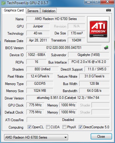

i bought a new graphic card gigabyte 6770 , it was only availaible in my budget
now its slightly underclocked i.e. core 775 Mhz , memory 1000 mHz
AMD over drive contains an option for overclocking upto 960/1200
i want to know if i overclock it will the warranty be voided and upto wat limit i can safely overclock it ?
and what are the consequences if there is any ?

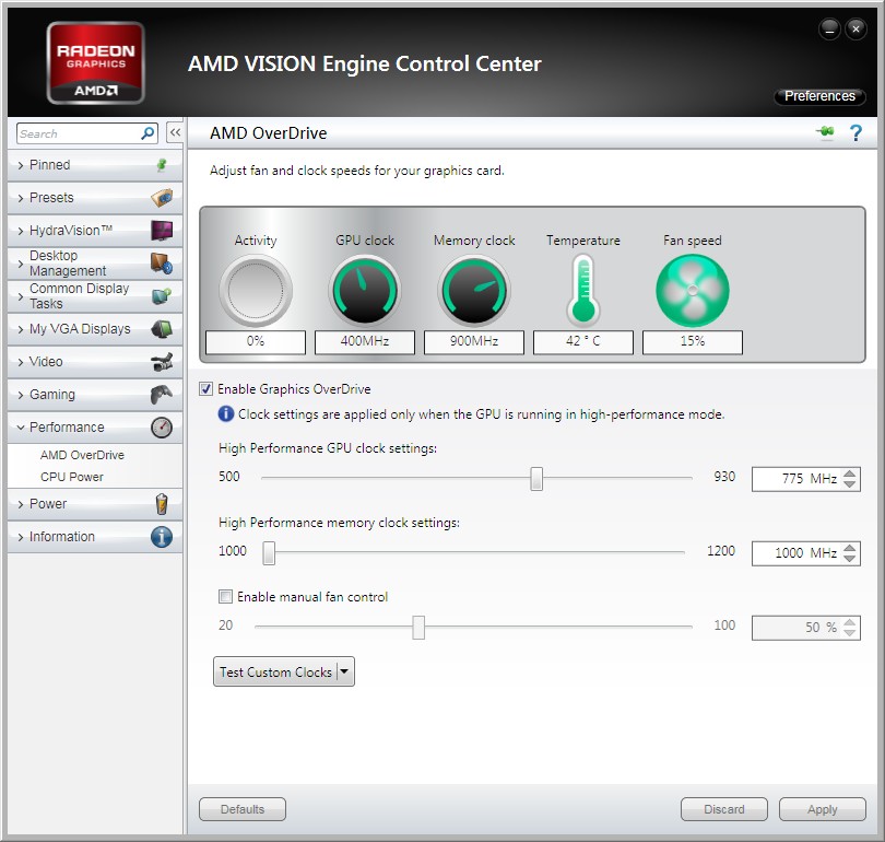

here is the pic of my amd overdrive , shud i overclock from here or i use msi afterburn?
Better that you use the MSi Afterburner software Sire.
Hope this helps, Cheers!!

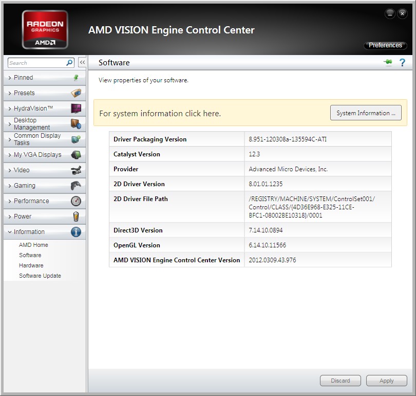

More importantly which Catalyst version are you on?

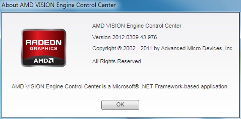

I was not asking about the About of the AMD Vision Control Centre, to find out which version of the driver you are using --
  • Open Catalyst Contol Centre / Vision Centre
  • Go to the Information tab, click on the same.
  • Select the Software sub-option, that will tell you which driver you are running.
If it below v.12.3, you need to update buddy.
Also Mafia II is a really heavy game, my friends GTX 460 1GB used to struggle to run it on high settings @full HD format. Even my HD 5770 1GB frames in heavy scenes and ironically I have the same resolution as yours 1600 x900.
Okay here is the latest edition for download --> http://support.amd.com/us/gpudownload/windows/Pages/radeonaiw_vista64.aspx
