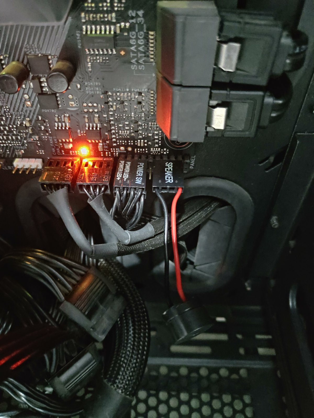

Hi,
Would you mind sharing couple of pictures of the speaker with connector alone and installed on the motherboard header?
Tried flipping it too and replacing with a new one from amazon, nothing worked.
yes as per manual I tried flipping it but nothing happened.
don't have any other desktop or motherboard to check speaker so I tried replacing the speaker but still an issue.
