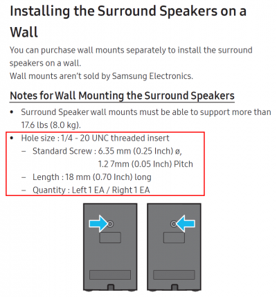

I need to buy these screws to wall mount my speakers. Where can I get it from? Any online link please.

Thats a 1/4 inch screw, so its a imperial screw. Most automobiles only use metric screw, so a dedicated fastner store will have them, although most may only stock metric screw. Its not that hard to find. In bangalore shops in SP road will usually have them.
What you essentially need is a fastener with 6.35mm (1/4") diameter and a 1.27mm (20 threads per inch) thread pitch. Local hardware stores are probably your best best, and if in doubt, you can possibly measure this in the shop, before you buy. As already pointed out, this is an imperial size, so you can eliminate metric sizes (M2, M3, etc.).

1/4-20 is a normal camera tripod screw (Smaller diameter one used to mount DSLRs etc to tripods, and not the larger 3/8-16 sizes used to mount video heads).
You're looking for a bolt with the following specs:
Thread Diameter: 1/4 inch
Thread Pitch: 1/20 inch (i.e. Threads per Inch: 20)
Screw Length: at least 0.7 or 3/4 inch
This is not a rare bolt; try the local hardware store and ask for 1/4-20 BSW. You can carry along a camera to test the thread by screwing the bolt into the tripod hole at the bottom.
Else if you really need to buy online, this might be a decent candidate.
