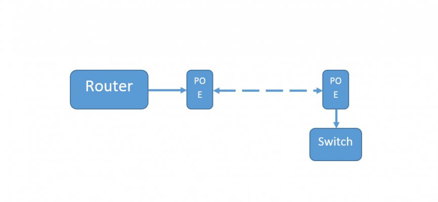

I have a DSL router connected to one of these and then plugged into the power supply and another one connected to the power supply and that is connected to a switch
TP-Link TL-SF1005D 5-Port 10/100Mbps Desktop Switch
Yes I think you could connect it to another router as well
