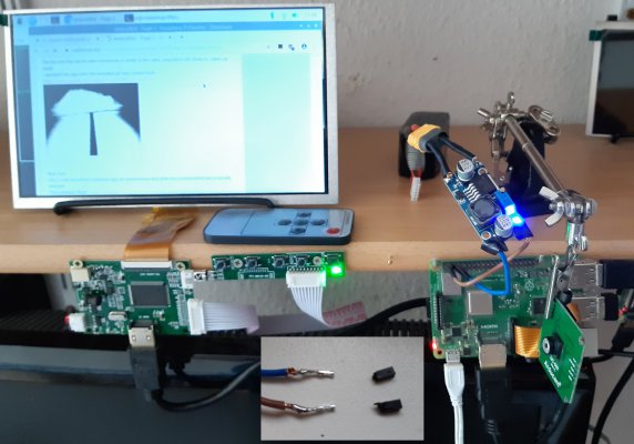

I just had a thought; you can also power the Raspberry Pi 4 from pins on the GPIO header. Using thick wire, supply well-regulated 5V to pin 4, and ground to pin 6.
Take care not to accidentally apply 5V to any of the other pins, as the I/Os are intended for 3.3V operation.
https://github.com/raspberrypi/hats...e.md#back-powering-the-pi-via-the-gpio-header
image via https://stamm-wilbrandt.de/en/forum/20200414_115932.f.jpg
