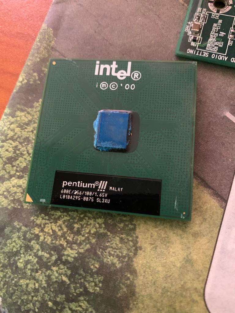

Edit: @rsaeon , you're a real one! Just as my thumb was starting to feel sore, the clamp popped off, revealing a glorius Pentium 3.
Also, before putting the heatsink back on, should I spread the normal thermal paste on the blue area (the die I'm guessing)? After wiping the previous one of course.
