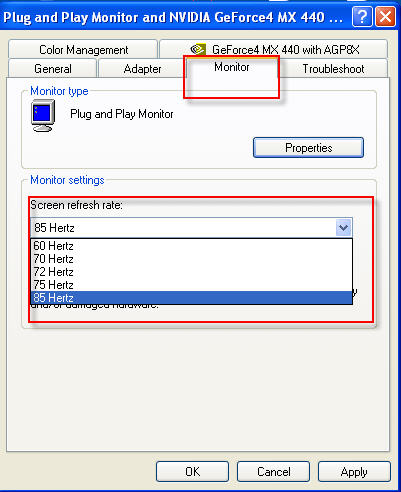

Increas your refresh rate to 85 Hz, the flickering will go away.

It'snot done on monitor OSD menu
right click on desktop --> go to properties --> settings --> Advanced Tab --> Monitor--> change Refresh rate in the drop down menu.

I can't change the refresh rate under the monitor settings! When I go under monitor settings the Screen Refresh Rate is set to 'Use Hardware Default Setting'. That's the only option available and Default Monitor Properties option is also blacked out.
I'm using on-board display, no additional graphics card in the PCI-e slot on this system. The motherboard is an Asus P5K-VM.
Any more ideas on solving this problem? :huh:
the drivers for the monitor may not be updated.
right click on My computer --> properites --> hardware tab --> device manager
under monitors -- check what it shows. if it shows 'Plug and Play monitor', it means that you first need to update your driver, then you can try changing the refresh rate to a higher one.
