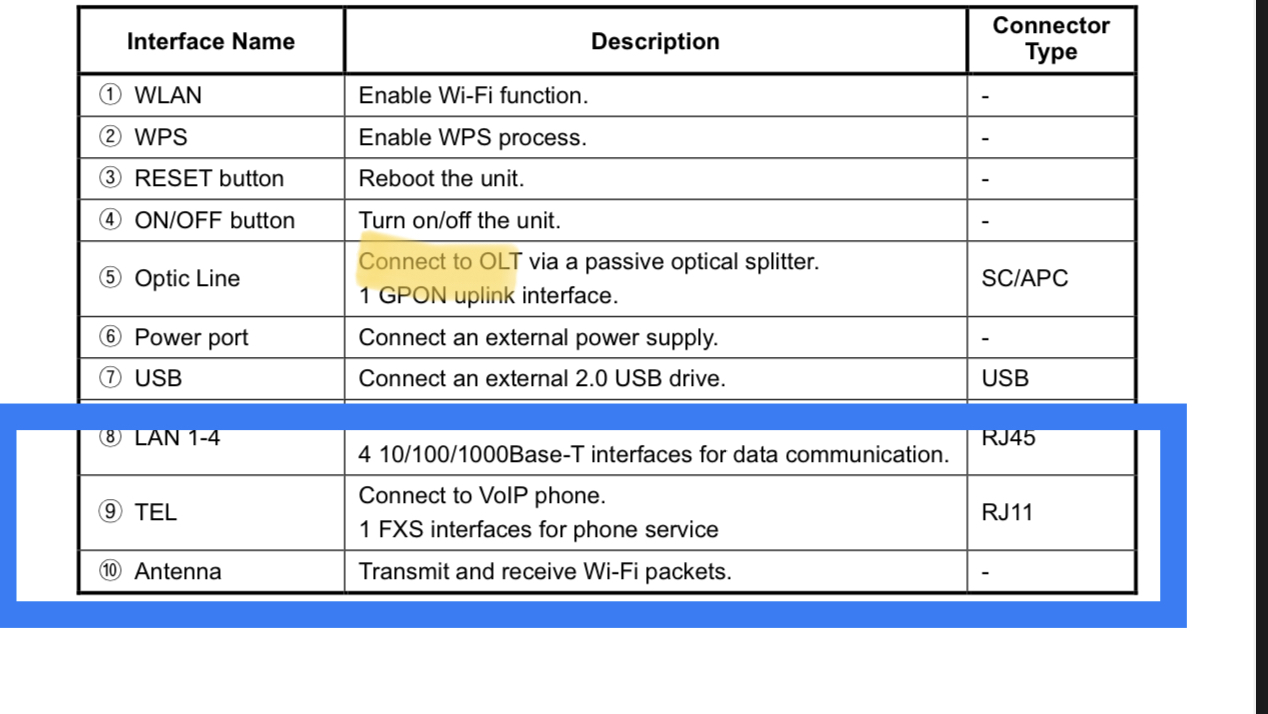

On the router it shows “TEL”. I found manual of the router online, as per that it is “Connector type RJ11- Connect to VoIP phone. 1 FXS interfaces for phone service”
ok, that is a regular landline phone then. Not one that uses VoIP?
It’s actually Airtel Fibre connection. So the technician said a telephone can be connected to the router.

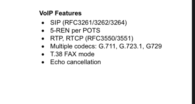

Any idea how can I check if it is regular or voip? Below are screenshots from manual. See if it’s helpful.

The 5Ren per pots means you can have 5 landline phones all ringing off it.
Can you find a corded phone with an RJ-11 plug and confirm whether it works when you connect it to the router? You must have one somewhere
Well sadly I don't have a telephone in my home right now. I can confirm it is RJ-11 plug at the back.

It has both from what you said. VoIP uses a regular IP network. So it will use an RJ-45 or if it has wifi it can connect to the router that way.
Since you have a VoIP router why not use your mobile to make wifi calls? no need for a cordless phone then
The telephone service provided is VoIP and your router has an inbuilt analog adapter for connecting regular corded or cordless phones.
As @blr_p said, you can bypass this analog adapter and route your telephone calls on wifi. Some configuration changes on your router will be required. Depending on service provider and ONU(router) the success percentage will vary.
Airtel is providing POTS and VoIP so either way should work
