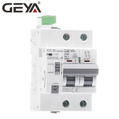

In my house I put a auto recloser elcb which auto recovers after it trips.
There is also a voltage protector after the elcb, that way all the expensive devices including my 5kva inverter is protected from high voltage and all the devices run on battery power, in the event of high or low voltage.
Trying to find those two on eleczo and coming up blank :(
I got mine from aliexpress, many sellers ship if you pay them via paypal. While using aliexpress just for communication. I got this product before the aliexpress ban. But I have got other things from other sellers after ban
Rs. 2,887.07 25%OFF | GEYA RCCB Recloser Control Part Only for Customer to Make Replacement

I have since shifted this to another premises and have installed a wifi elcb with more functions but costs close to 10k.
Voltage protectors or sold by plenty on amzon india.
I think so atleast if the description are to be believed. But look at the size of that thing, that is not MCB form factor but rather the much bigger MCCB form factor.
Auto recovery vs auto recloser. The later closes your existing mcb mechanically after it detects a earth leakage event and then auto recovers i.e opens your MCB switch upwards after a few seconds.
