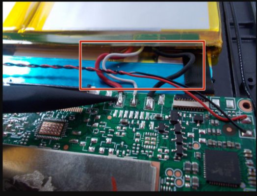

What are the white, red and black cable on tablet pc battery,
If battery is dead and we want to power the device directly from the charger, can we just connect the cable to motherboard/logic board on tablet, to power on the device.
or do we need some resistor/capasitor/circuit etc in between.
can we just use any 2amp 5V charger on tablet and power on the device, what is the use of white cable, can we skip connecting that ?
here is a picture for sample.

U need 3.7v to power up the tablet motherboard but if u are using a usb charger which is 5v, in this case the 5v has to stepped down to 3.7v elese u will fry your motherboard. In this case a voltage regulator/ buck converter will help you step down 5v to 3.7v. that step down converter is the extra circuit module u can buy in local electronics Store. Don't try to power up the motherboard without that module. Then kaboom !
Btw the white wire is for temperature sensor present in your battery. in ur terms U can simply power up the board using red and black. White is not needed

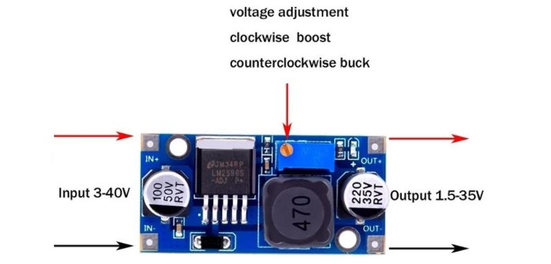

Jus Google search "LM2596 module" and see how to adjust the voltage output in youtube
ok, so i searched for that module and it looks like this
what i understand is that,
1) i will connect the charger black and red cable in input
2) i will buck down the output voltage to 3.7
3) will check with Multimeter the output to 3.7
4) connect output + and - to motherboard, where battery was connected
Please correct me if wrong,
Also i think all battery has inbuilt circuit , can i use that
Inbuilt circuit will not step down. Also that is for charging the battery.
The above 4 steps are correct and u can proceed
