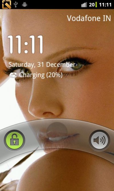

CM 7.1 mod Lockscreen of my O2x :)
[attachment=10824:17826.attach]
