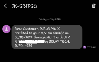

Got a whooping 23.9k worth refund from ZOPPER (SOLVY TECH SOLUTIONS PRIVATE LIMITED) after filing complaint in consumer forum. :cool:
This was the fastest justice delivered just within 72hrs! Dont know what all charges are included but it seems they levied harassment, service etc. charges.
That's chappar phadke. Nice.
Interestingly the extended warranty cost was just Rs 4825 per tv.
But we attached the latest invoices from Sony as well as we paid 11.4k for the display.
So in all we got 3k more.
Really happy with the resolution.
