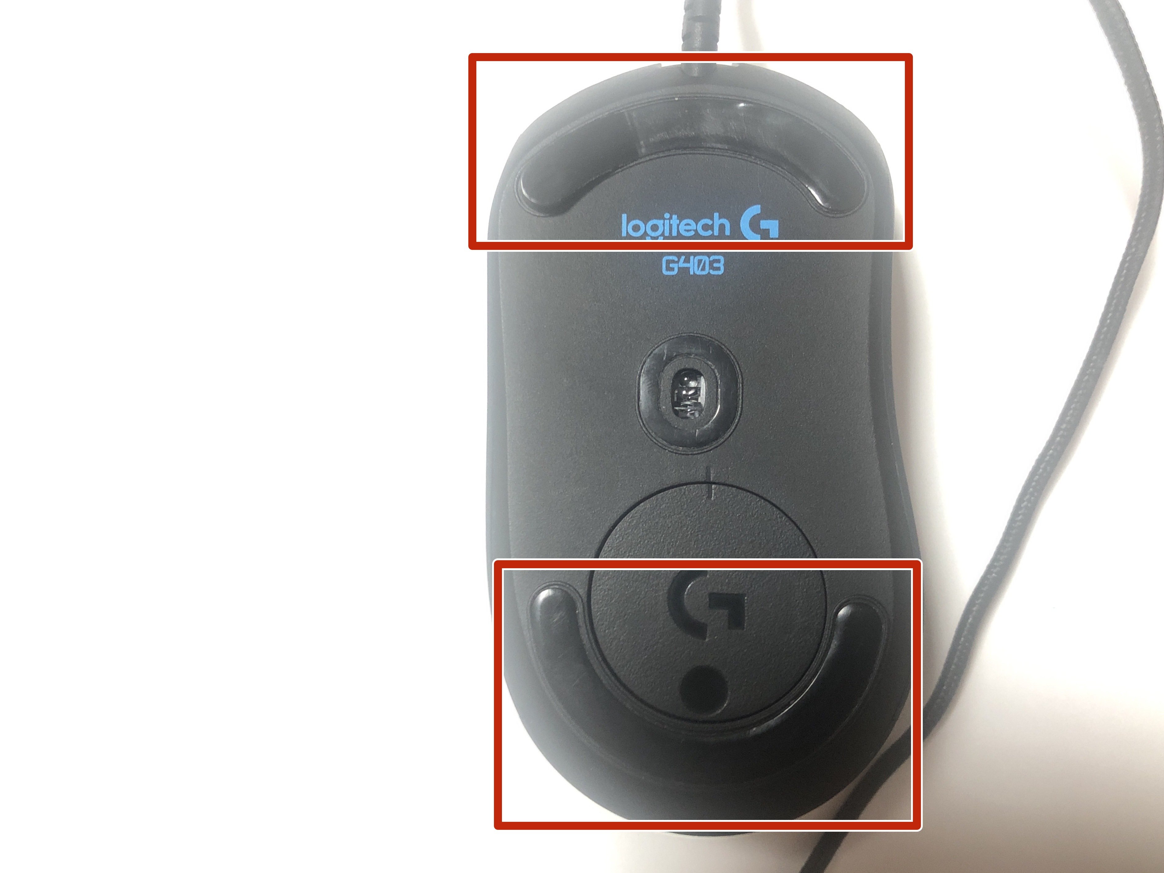

I am using Logitech g403 at the moment and it has started giving me super double click issue.
What should I do ? Fix it or replace it.

You can fix it. Open the whole mouse. Then open the switches too. And clean the copper contact points with a polish papar. There are YouTube videos that you can refer to.
This Tutorial Should Be Helpful ..However I Prefer Fixing as that does exercises our Neurons , also saves money , hope you get my point bro.
Just yesterday I had bought a used Razer Deathadder Elite + 1 replacement switch from a fellow member who generously was selling them for very reasonable price due to the double clicking and scrolling issues.
I operated on that mouse and fixed it without replacing the switch. It's working fine right now but it remains to be seen for how long though.
I cleaned everything with Isopropyl alcohol (91-99%). Opened the switches and cleaned the copper place and contact points. These are very small, delicate and a little difficult to handle. Extreme care is needed to not ruin the switch as these are not really serviceable components and are meant to be replaced.

I think so for now, yesterday just cleaning it with IPA seemed to have made an improvement, it scrolled randomly less than what it was initially. So I opened it again today and cleaned it again with a LOT of IPA and this time the switches too from inside by opening the switch (yesterday I only cleaned from casing of the switches), cleaning the plates. Then dried it out and tried again so not randomly scrolling up and down now but IDK how long it'll last. Time will tell...
EDIT: I feel like right switch had a little bit of corrosion from inside cuz I saw green color on the contact plates, perhaps that was causing double clicking (although it was not that often). Left click is not sounding the same as right click, like the sound is softer but still clicky, probably because of being more used than right.

I fixed it and now its over fixed. don't know what to do. the left key is what gives me issue. now its so sensitive that I have lost the tactile feedback and its screwed up more. may be new mouse is what I need with an optical switch...
I happen to did that once with a g102 switch which was my first time trying to fix the switch. Perhaps you bended the copper plate too much that it's very flexible now or you just didn't place it properly into the 2 grooves on the switch bottom housing.
In any case I ended up replacing the switch on the g102 eventually and it worked but had to throw it out due to some other reasons some time later due to my anger issues ;) .
I think you probably didn't assemble it properly. You may want to have a look at the assembly of the other switches in the mouse and reassemble the left key.
When we clean it like this, the tactile feel and sound changes and that's normal. It'll come to usual normal tactile feedback after a few weeks. This will last for years. If it took 3 years to develop the issue then it'll take same time to develop the issue back again. Use polish/grit paper to clean. If you don't have that then you can try lightly scraping with a blade.
