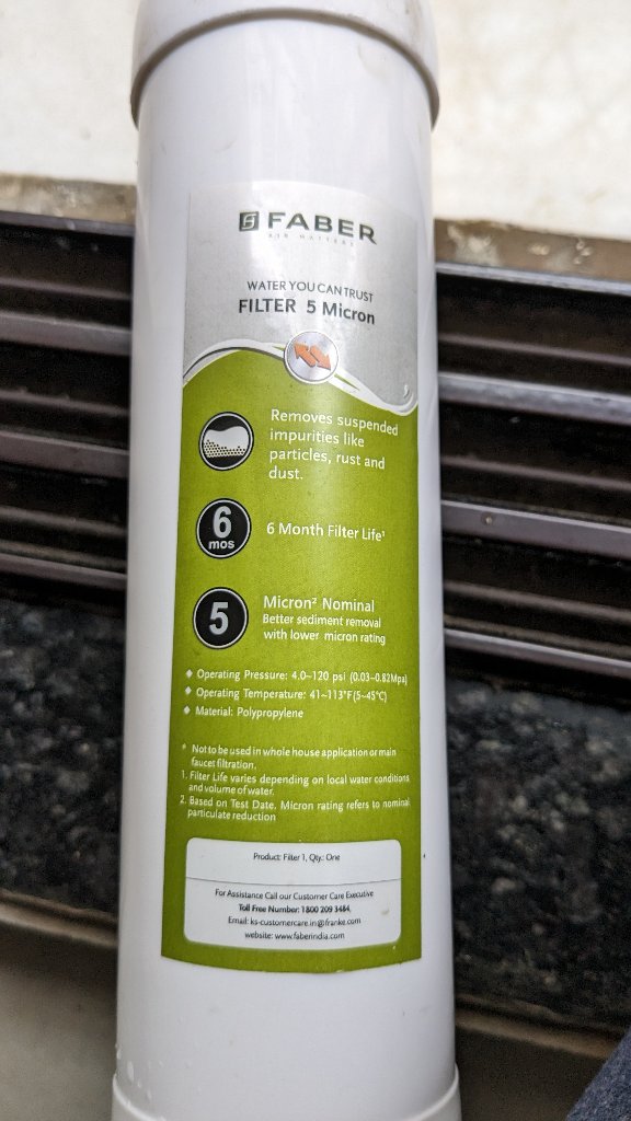

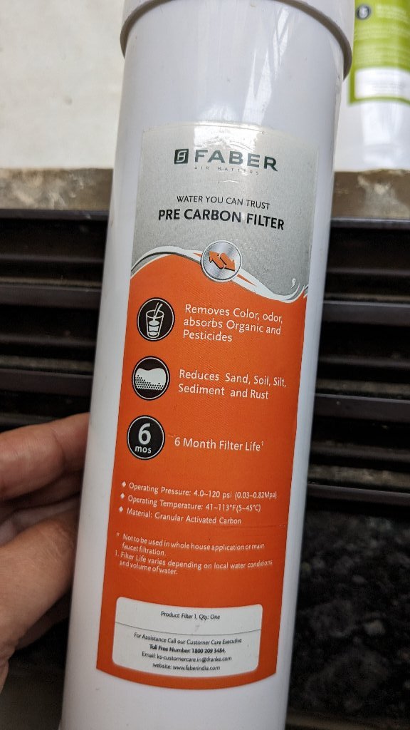

Is there anywhere we can get Faber ro filter replacements from? The company seems to be using non standard filter and they are charging a lot during replacement. Their amc cost is 5800 rupees a year and i see their ro filters unit sell for around that much. It's nuts. It's like buying a new ro unit every year and scrapping the old one.
The sediment filter width is 7cm (2.75inch) and height is 25.8cm (10 2/16 inch). This is the only non standard part i think. Even the filter inlet is double than 1/4 (3/8th?) but outlet is 1/4. And it's a 50 micron filter.
The above two seem like cheap filters and cost 599 each. The sediment filter costs 299. The ro filter around 2300 i think. And these filters only last 6 months and the ro filter lasts 1 year instead of 2 years like the generic ones.
Searched Amazon and just a few sellers selling the 7cm filter but height of filter is smaller.
I have the 2.5 inch filter and it's like half of the filter housing and it doesn't sit properly since its about 3-4mm smaller in height.
Should i just replace the non standard filter housing with one of the generic ones? It will be easier to maintain and cheaper. An entire RO replacement kit comes for around 2-3k for good quality ones on Amazon now.
This is the reason I have recommended it here or elsewhere in another thread never go for this branded water RO. All the generic ones fairly do a great job. And you can buy replacement filters anywhere offline / online. They design in such a way the generic ones won't fit in and you have to buy the high priced filters from their own brands

I found that site through Google and the quality looks really cheap. I'm sure those filters are just generic ones being sold for double price and they won't fit. The faber sediment filter is 7cm thick and these guys are selling 4cm filter. Doubt that they tested it before claiming that the filter works. I have a bunch of the 4cm filters and enough spare parts to build a new water purifier and i can vouch those 4cm filters don't fit. I actually tried to force fit one of those but the difference in height made the filter wobble inside the housing. The 10 inch filters are about half a cm smaller in height.
Edit: found these.
Water Purifier Thik Outer Filter Candle/Spun Cartridge (10 inch/2.76inch) - White (Pack of 6) https://amzn.eu/d/bI6gwwg
There was another blue coloured filter whose seller claimed it was anti bacterial or anti fungal i think.
Edit: found these.

I know you replied to another person but i had bad experience with both wellon and aquadove filters. Aquadove is a Gujarat company and they don't test their products. I have their ultrafilter system lying unused in a box now. When i bought the whole system, there was no leaks since everything fit perfectly. I installed it myself. Then i bought replacement filters and the size and quality was different. The carbon block smelt of some chemical and while flushing the water i saw green colour water. No matter how much i flushed it it still stank of some chemical smell. It killed the old uf and post carbon filters in just two months.
After this i bought wellon carbon block and even that wasn't good at removing smell from water and it was about a mm smaller in height. So i had to use a plastic pipe to fit it in the housing. Without the plastic pipe, the housing would leak water. All these Indian companies just randomly buy anything from China Alibaba and sell here for marked up prices. I doubt they do any testing or qa on the items shipped to them.
