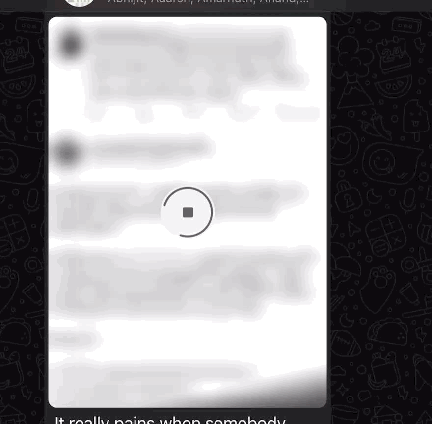

- On WhatsApp, viewing images and viewing status stops working/downloading randomly, as soon as I switch to mobile network the same images and status downloads fine.

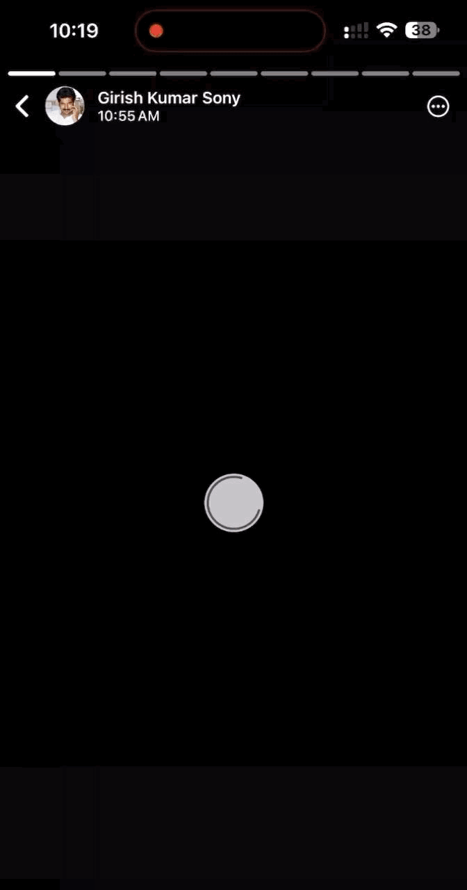

- On Instagram, Reels/videos stop playing with a buffering rotating circle, happens randomly and not for all the videos, same issue not present on mobile network.
Both the above issues happening on all mobile phones on home wireless network (all phones are iOS), WhatsApp on these same phones work fine on mobile network or outside Wifi network, also WhatsApp images and status work perfectly fine on Windows app or WhatsApp web.

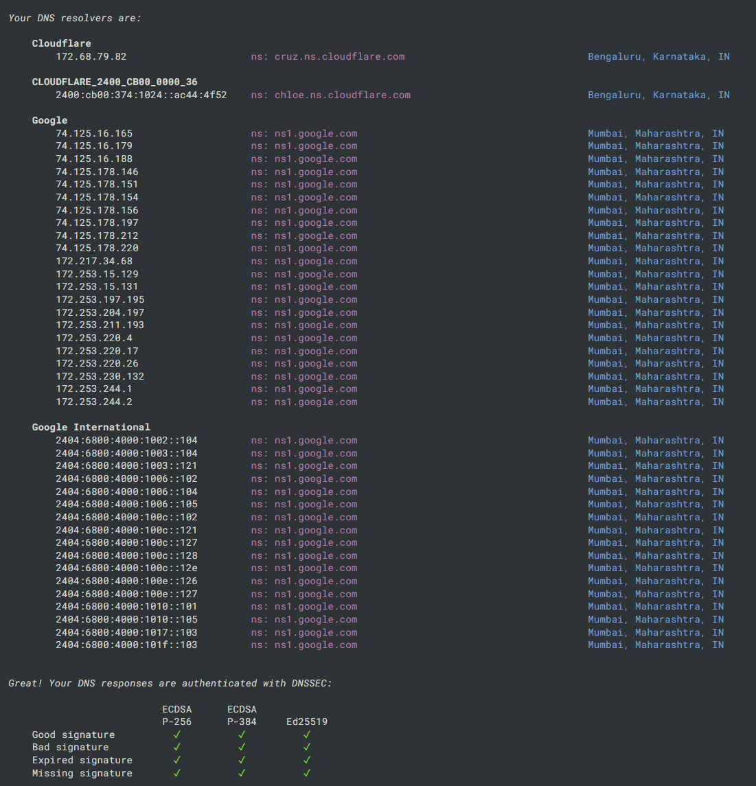

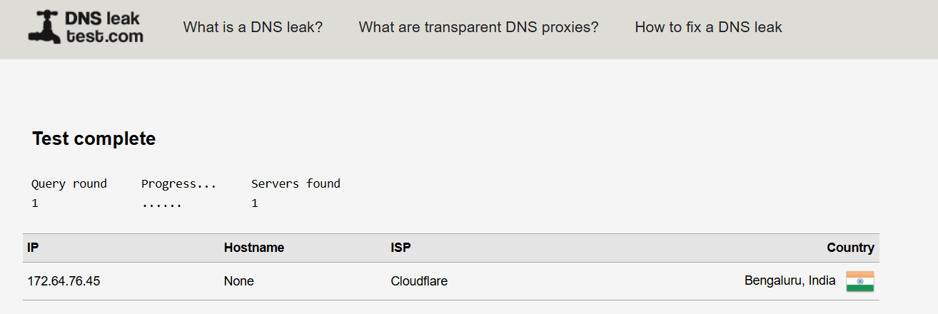

- Tried changing DNS to Google & Cloudflare (issue remains same)

I will share videos soon, which shows the exact issue
oh yes I completely missed to update, I have changed the DNS to Google and also to Cloudflare but the issue remain the same
also one aspect I remember is I had setup a AdGuard server and was using the AdGuard DNS across my network (which I had added in my Asus router)
After couple of months removed the Adguard server moved back to Google DNS
I guess this issue started after this but I’m not completely sure
