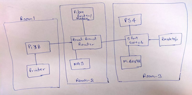

I was having a network/PC setup as for attached diagram.
I have HP Ink tank 310 Printer which was in other roomand printer does not have any Ethernet port,only a USB port. I was unable to use printer on my network as it only came with USB. I was having a spare Raspberry Pi 3B. This guide is based on using it to convertUSB printer to network printer and using it with all network devices for printing.
