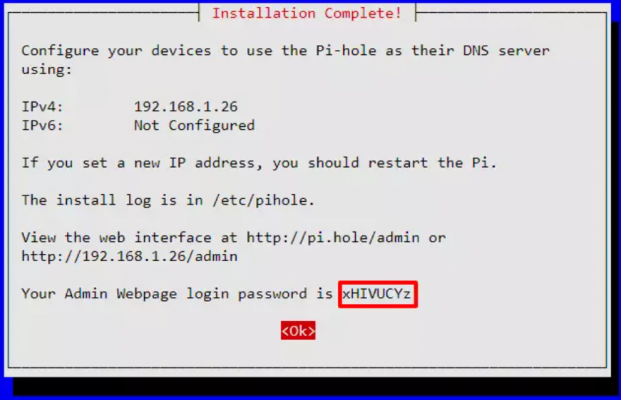

This guide is about setting up PiHole on home network.
Log in to your raspberry pi and run this command in terminal:
Code:
curl -sSL https://install.pi-hole.net | bash
1. The Pi-hole installer should begin. You will have to use a similar console style navigation of tabs, arrow keys and enter/space bar to navigate the options. If you get stuck at any point, pick the default.
2. Pi-hole needs a static IP to function properly so assign a static IP Address. If your device has more than one network interface, you will be prompted to pick an interface. We are using the wired interface, this should be named enxxx or eth0. Ethernet is recommended here for reliability.
3. Next, you will be asked to pick a DNS provider.
4.Enable 3rd party blocklists.
5. Leave Protocols as default.
6. Confirm the static IP configuration.
7. Confirm web interface.
8. Finally, you will be presented with a screen saying that the installation is complete. Please note down the password displayed on this screen because this will be the password that we will use to login to the web dashboard.

Enter the password generated by the Pi-hole setup before and log in.
