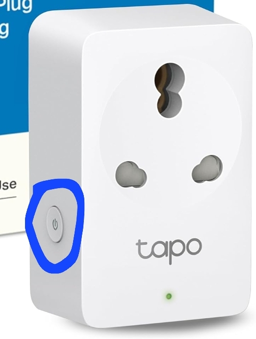

Tldr; I need a smart switch which can be controlled manually as well.
I'm looking for a smart switch which is old way proof for my parents who are not tech savvy.
Basically if turned OFF by app it should allow to be turned ON by manual button and if turned OFF by button, it should allow to be turned ON by app.
I Couldn't find any switches which fits this requirement, or were having confusing specifications.
Edit: looking for smart plug and not smart switch.

Almost all smart switches in the market work this way.
What about this one?
TP-Link Tapo P110 Mini 16A Smart Wi-Fi Plug, Energy Monitoring | Controller for Household Appliances Compatible with Alexa, Google Home | Improved Power Safety | Away Mode | 4-Way Safety Protection https://amzn.eu/d/9PqUZai
Does this also work the same way?

This is a smart plug, not a smart switch. Smart switch is something that goes inside your existing switchboard and is hidden from outside. Smartplugs need to be used with the socket on switchboard. For obvious reasons, smartplugs will only work with devices that can be plugged into sockets whereas smart switches will work with any switch (light, fan etc.)

Thanks, if you're using one, can you please test this below me?
Turn off using manual switch, and then turn back on using WiFi.
If you turn off a smart plug using manual switch, there is no way to turn it on using automation since it doesn't get any power.
I use smart switch and this scenario is simple....even vice versa.....don't get complicated....your scenarios are simple, nothing unusual.
He is talking about smart plug and not smart switch.
Are you talking about the manual switch on switch board or the one given on plug itself?
