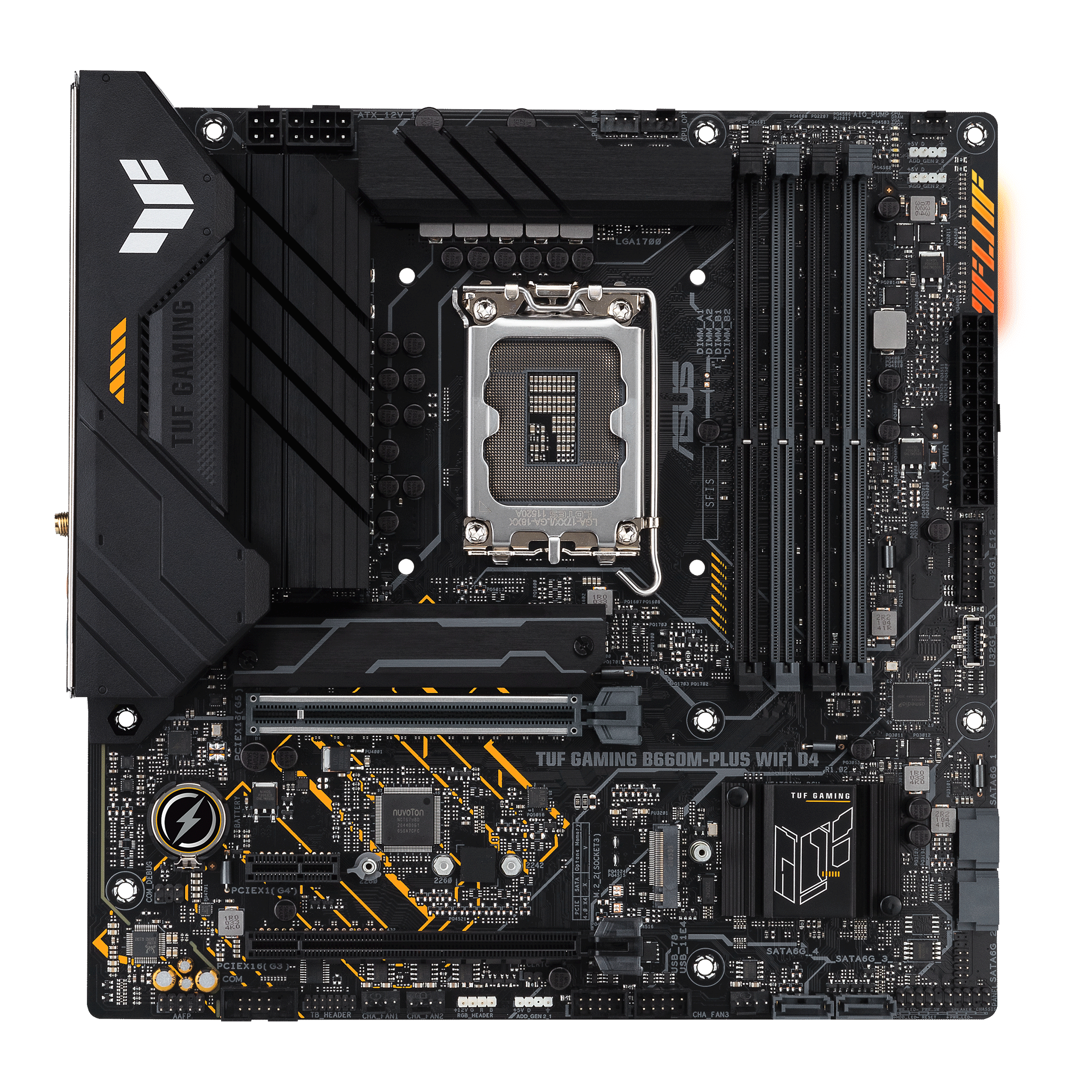

This is the small Asus antenna via which I am at present connecting laptop windows 11 amd other devices to windows 10 pc

You're connected over Wifi N, with 1T1R, 20MHz bandwidth, and likely on the 2.4GHz band. Your wireless hardware on PC probably does not support access point mode (hostap). All this translates to terrible wifi performance when using the PC as an access point.
Looks to be 2.4Ghz. So 72Mbps is the connection link and he's getting 5-6MBps of transfer speed. I don't see anything wrong with that. It's near capacity and working as it should.
Wanted to confirm as OP's Mobo defnitely supports a 5Ghz network.
@op Try to use the 5Ghz network in whatever software you're using to setup the hotspot.
Also, since you need to transfer 100GB of data every week, you're better off connecting both devices (between which the transfer is going to happen) to a wired connection and make sure that you have gigabit ethernet on both devices.
If you do not have gigabit ethernet port, then you're capped at 100Mbps there as well, so you need to again look at a 5Ghz network connection.
I'm also not sure why you want to stay away from a router, you have a 18k motherboard, spend 2-3k on a router, anyways, just a suggestion.
