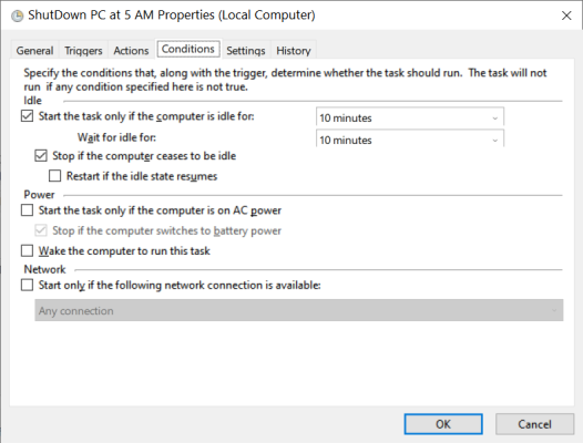

I have a custom task in windows 10 to shut down my pc every morning at 5 am (if PC is idle).
Scheduled turn on at 8 am from bios everyday.
If any download or any activity is running, PC won't force shut down
But I have noted, pc will shut down after activity is over at any given time of day later.
(once that activity is over)
But it will only start again at 8 am in morning.
I need to set it up in a way, where it will only shut down at 5 am if no activity is running. If activity is on, postpone shut down till next day 5 am not before 5 am.
This causes trouble accessing pc, when not in front of same or via other devices.
Any possible suggestion to fix this?
Apart from calling and requesting someone at home to turn PC on.

OK, from the xml file it doesn't look like those settings are enabled, although run on demand is enabled but that should be fine.
Are you sure that it is task scheduler that is triggering the shutdown rather any the app running? e.g., some torrent and other downloading apps have the option of "Shutdown once download is complete" have you configured these?

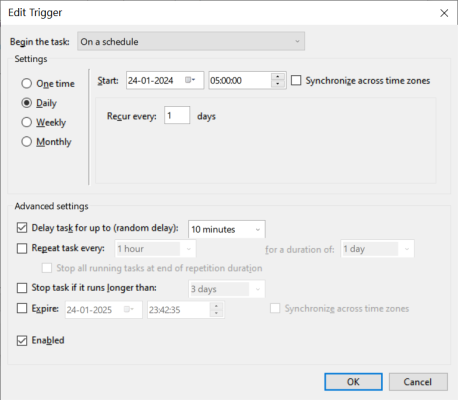

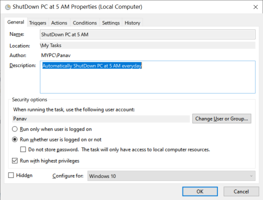

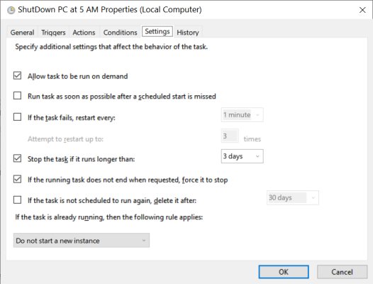

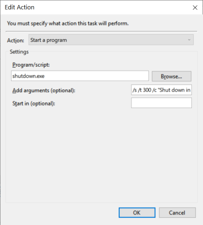

I am attaching all settings of my task..
I have checked the setting to run task as soon as it is missed (was unchecked)
There are some fb activities on as well if not downloader (which is turned on once/twice a month)

Not tried but i understand that will force restart, even when i am using PC.
The wait for idle condition is subset of the main condition which is "start the task only if the computer is idle for 10 minutes" so my guess is that waiting for this condition causes pc to run this task continually after 5AM so pc keeps waiting for 10min before it checks if computer has been idle in last 10 minutes & if not then whole process repeats again until both conditions match which may happen anytime after 5AM especially if whatever activity you are expecting don't occur during the day.
