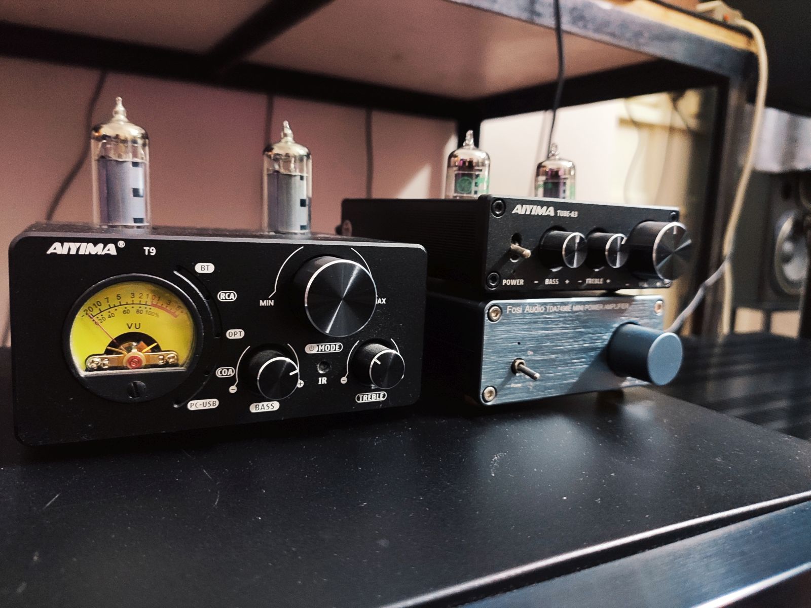

Please note I use my SONY BOOKSHELF SPEAKERS ( I call them bookshelf as they perform really well and partly coz I don't have the machine) with this.. The ones which came with Sony MHC-Az2d music system. (edit attaching pics of them)

![20230824_212808.jpg 20230824_212808.jpg](https://techenclave.com/data/attachments/173/173524-a7ac98e80b8fcde720772490111b4dd7.jpg)
![20230824_213245.jpg 20230824_213245.jpg](https://techenclave.com/data/attachments/173/173525-ae7c4ea561130b6d62c199a5a2968a4b.jpg)
![20230824_213212_HDR.jpg 20230824_213212_HDR.jpg](https://techenclave.com/data/attachments/173/173526-a68a47ae03aeca76f2b9487075c89188.jpg)
![20230824_213142.jpg 20230824_213142.jpg](https://techenclave.com/data/attachments/173/173527-31dfbf9cbf3333a6d4279c932d86c63c.jpg)
![20230824_212831.jpg 20230824_212831.jpg](https://techenclave.com/data/attachments/173/173529-18b9e4dc78dab9fc4e89cd4a41020177.jpg)
![20230824_212837.jpg 20230824_212837.jpg](https://techenclave.com/data/attachments/173/173528-75ae19e6b2d8462bb7e7914cc8545f86.jpg)
![20230825_155554_HDR.jpg 20230825_155554_HDR.jpg](https://techenclave.com/data/attachments/173/173534-35fc78bee03af58876f217d40371eaac.jpg)
![20230825_155635.jpg 20230825_155635.jpg](https://techenclave.com/data/attachments/173/173535-fc9bd2e1e51bd692fe637e94bf715db7.jpg)
