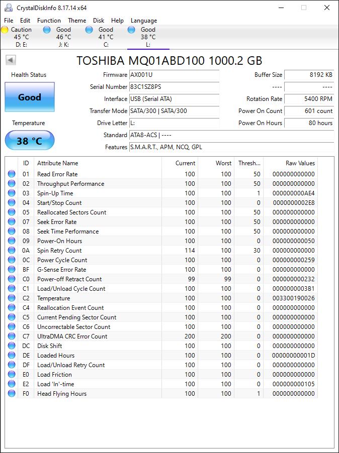

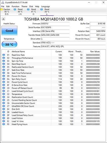

Check the drive for bad sectors using crystal disk info. If they have a lot of pending sector reallocation counts it’s bad. Otherwise it could just be some mechanical issue with the drive.
