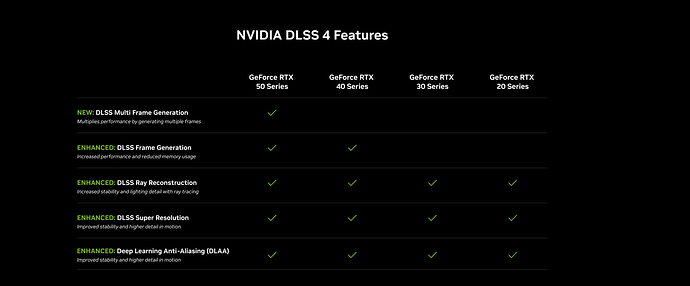

DLSS4 works on 3000 series, its a bit slower but still very usable and works very well. DLSS 3 performance at 4k was blurry in motion, but DLSS4 perf 4k looks very good. Might be sharper than 3 quality ( but with artifacts ). One good thing that came out of 5000 series.
Just need to replace dll as usual. I am using it on 3080. And in FSR only titles, we can use optiscaler to use DLSS4 instead of FSR2/3.
That’s true to an extent — the new DLSS4 SR/Quality modes can be made to run on 20/30/40 cards through DLL swaps, but official DLSS4 support (esp. Frame Gen) is still RTX 50-only. So while it works, it’s not “native” and can be hit-or-miss depending on the game/patch.
Not really, upscaling is supported. Where are you getting this info ? AI ?
In cyberpunk i get option for transformer model without dll swap. The fps gains are reduced a bit vs dlss3 as upscaling time is more in 3000 series. But there is no hit or miss, it works and works well. I only use DLSS 4 now in every game.
DLSS FG yes, not supported. There is FSR FG, but anyway i think FG usefulness is very limited and generally even less useful in this price range. FG should not be a factor here.

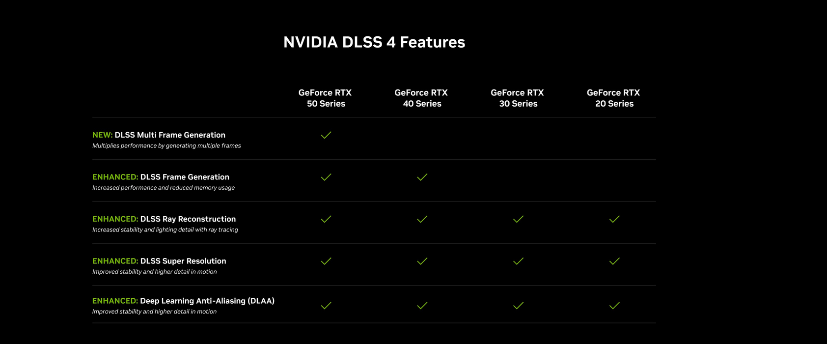

DLSS 4 is officially supported on the 20/30 series as a pure upscaling method. What’s missing is Frame Gen

Just to clarify the current state of DLSS4 and FSR4 support — there’s a lot of confusion around what actually works on which cards.
NVIDIA DLSS4
Super Resolution (SR/Quality):
Works on RTX 20/30/40/50-series. In some games (Cyberpunk being a notable example), the transformer models even run on 30-series without any DLL hacks. So if all you want is upscaling, most RTX cards handle it fine.
Frame Generation (FG): Officially, this is limited to RTX 40- and 50-series.
Multi-Frame Generation (MFG): This newer frame-multiplying tech is exclusive to RTX 50-series.
RTX 20/30-series: No official FG support. There are unofficial workarounds, but results are patch-dependent and inconsistent.
AMD FSR4
Officially starts with RX 9000-series.
RX 7000-series can sometimes run it via beta drivers or Linux builds. Performance is improving, but it’s not fully stable yet.
Key distinctions to keep in mind:
Official support = listed by vendor and driver-level integrated.
Native support = works out-of-the-box, no DLL hacks or game-specific quirks.
Honestly, when people ask GPU suggestions based on DLSS4/FSR4, I usually don’t go down all these edge-case hacks because you really have no way of knowing how comfortable someone is with unofficial workarounds. Best to stick with what’s officially/natively supported.
